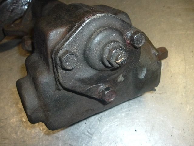

I don't know if previous postings have covered this or not.
Look at the top cover on your steering gear. Are there any threads showing on the sector shaft adjuster screw where it sticks out of the lock nut?
If the top of the adjuster screw is flush to the lock nut, the gear has been "adjusted" in the past and there is no longer any adjustment available. It could also mean that someone over-adjusted the sector shaft in the past and it is binding (and has probably ruined the gearset inside the gear housing at the same time.)
There should be several threads on the adjuster screw visible.
Jim

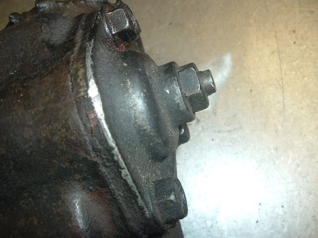

Thanks for the help. Here's what it looks like:

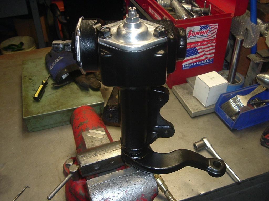

Well, the box has been completely rebuilt. Hopefully, this solves the problem.

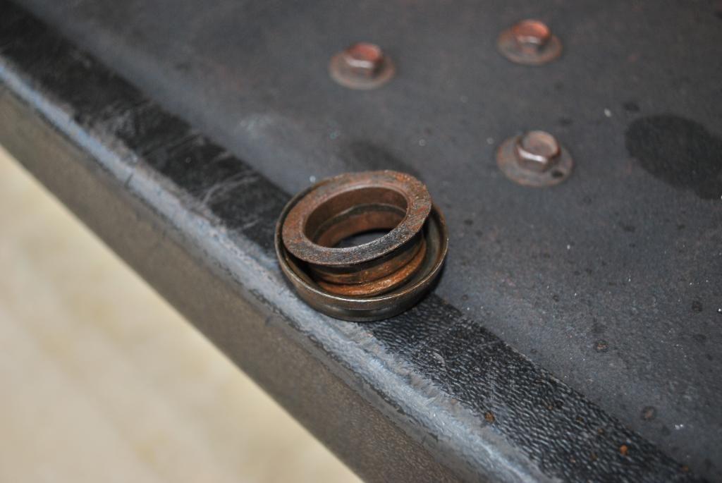

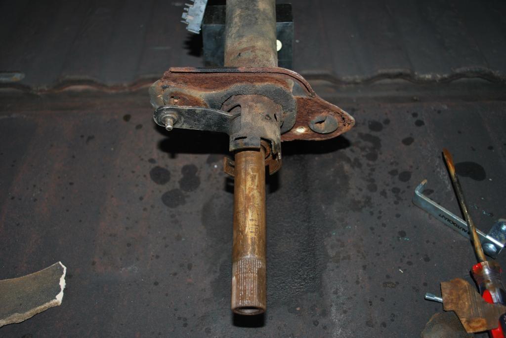

I started to install my newly rebuilt steering box today and noticed that the steering column lower bearing had practically disintegrated. So instead of looking the other way and continuing with my steering box install. I decided to pull the steering column and replace the bearing. This car just keeps on giving...
