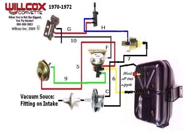

Has anyone converted their headlamps to electric and retained the vacuum actuated wiper setup?? If so, how did you supply vacuum to the wiper door actuator? Sorry in advance if this is a dumb question.

If you are doing this, the best thing to do would be:
For the small hose side, block off the hose where the T is for the wiper tach solenoid. that stops the small hose side. Basically remove 7 black/white stripe hose (by the headlamp switch) from the system and it knocks out vacuum to all the small hoses on the headlamp system.
For the large hose system. You'll need to plug off the yellow and green hoses that feed the relays and leave the yellow hose intact that feeds the wiper relay.

My fault for not being more specific. I'm removing all the piping associated with the headlamps to include the vacuum canister on the drivers side. Is there a way to set up the wiper door as a stand alone system?

How rude I am. Thanks for the quick reply! I really do appreciate the feedback and diagram!

There you go..
Headlamps removed..
