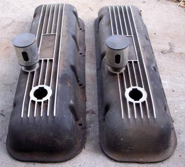

This is the Moroso air-oil separator system, just plumbed into the line between PCV and a tap on the intake. Handy petcock to drain. Don't know if it catches everything, but there definitely is oil caught by the tank.
Just thinking generally, with valve cover breathers only, the lowest pressure in the crankcase is going to be atmospheric. With a vacuum pump or connection to PCV, pressure is automatically lower, except at WOT with PCV. The tank is a good, not too expensive (approx. $150) solution. IMO. Works for me on 540 anyway.

That's pretty cool, didn't know they had a product like that. I'm gonna have to check those out some.
Also a pvc, header evac or even a vac pump will keep your oil cleaner and reduce leaks, so it's not just about emissions with a pvc.
pvc is more effective if done w/o a breather other wise it's a controlled vac leak that sucks outside air drawn through the engine to the carb. I know some setup are like that from the factory, but it still doesn't make it more effective.
If your getting too much oil from your pvc chances are you got other problems and something like that moroso unit can Band-Aid it. Gasoline itself has some oil residue and some of the additives are a "top end lube". One of the top superstock guys uses a pvc like system, but I can't go into details.
And the header evac not to be used with a muffler I've herd sometimes with backpressure the system can do the opposite. Since I run mufflers and even a manufacturer of a header evac system says not to be used with mufflers that's good enough for me.

Moroso breathers do the trick for me
