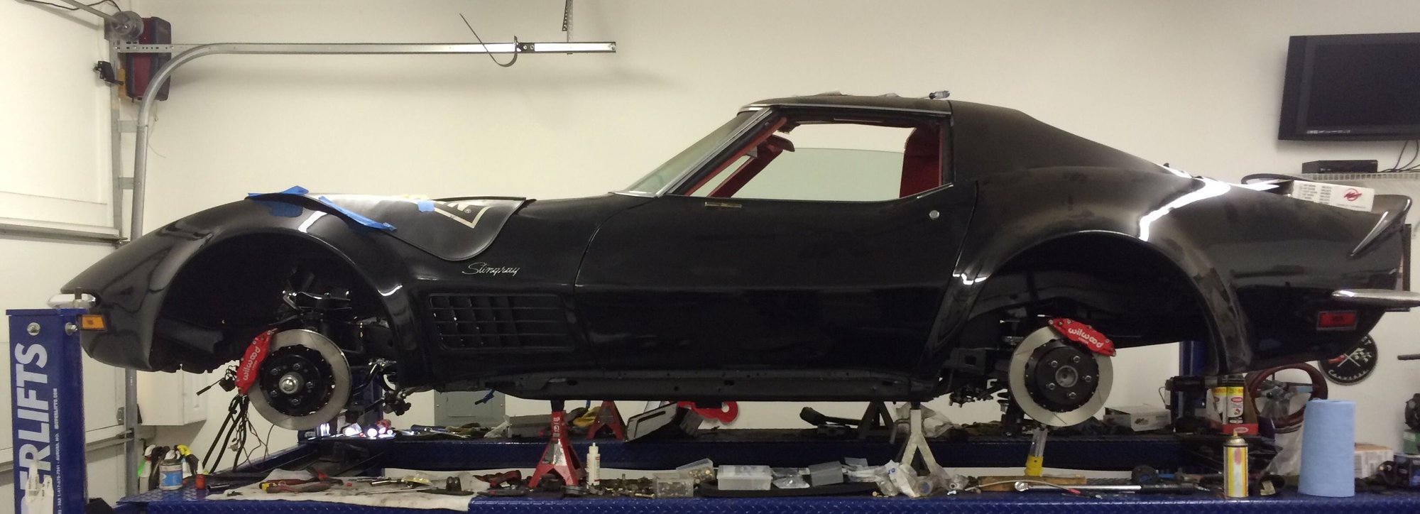

Does anyone know if there is a supplier making a mounting bracket for the accelerator pedal that is supplied with the LS3 crate motor & harness ?
I have been googled out with no luck
Looks like everyone is making their own brackets ???
Any help is appreciated
Thanks

Originally Posted by Gordonm
I made my own for my 72.
Yea, I was afraid of that.
Seems like some one would be stamping these out with all of the conversions going on like this ?
Thanks
I have learned a lot from your thread
Thanks Again

Originally Posted by sfsvettes
Do you have a build site for that car and what rear spoiler is that? Thanks

Made a plate for mine as well. Had to bend the pedal a little as well. I would have swore I recently saw someone do it just a little differently but can't find the post.

Same here. Made my own plate and bolted to the firewall; also bent a little, but keep room for the carpet and insulation against the tunnel.

Very easy to make a plate, that is what most of us have done. I have not seen a supplier offer this as of yet.

Thanks Guys,
I guess I will try to make on then...
* No I do not have a build thread, spoiler is homemade
I will try to post a few photos
