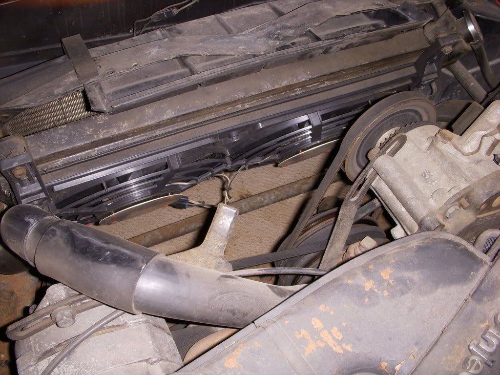

This is a Flex o lite fan but now it's a summit racing fan sold under their name for around $300.
It fits perfect and works great! I would strongly suggest upgrading the alternator but it's not necessary. I'm still running stock 85 amp with AC.
