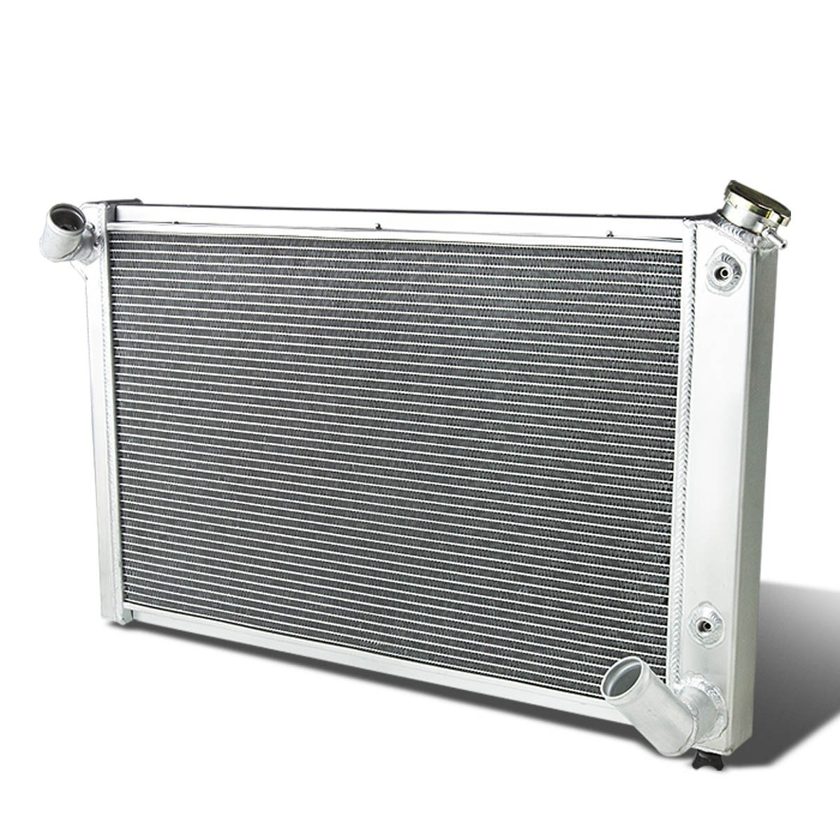

this is the radiator im attempting to install. The previous radiator was ~33 inches in width core 27.5

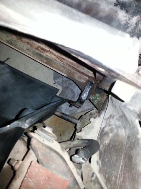

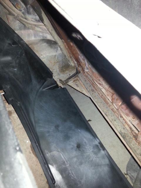

if you notice the left side lower tab matches fine but the ride side is off by ~3-4 inches

The radiator looks real nice. Not to sound like a wise gut but you mentioned that your car had many different things going on. Is it the right core support. Measure end to end and see if any vendor has a vette support that size. I would check with Coffman.

you need to determine if you have a small or Big support, ?
27.5 inches is for BB radiator
the only real difference on the support is the location of the passanger side,
bottom radiator mount width distance.
sounds like you have a BB support, and ordered small block parts.
yes you can swap out support,
if it were me I would keep the BB support and get the BB parts, more cooling capacity this way.
good luck !
