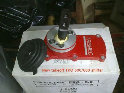

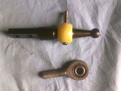

First, I would take the shifter off and check the bushing. There is not much to this type shifter. There is a rounded ball on the bottom of the shift lever that fits into a socket on the shift rail. There is a bushing inside that can wear. I know you said it was low miles, but I would check.
Here is one I found in about 10sec of looking.
http://www.ebay.com/itm/Ford-GM-Dodg...-/261663351878
I think you could still replace the shifter with a shorter throw version if needed. It would be a matter of taking the old one off and matching it up. The worst case would be you might need to have the shift lever mount welded to match the console offset.

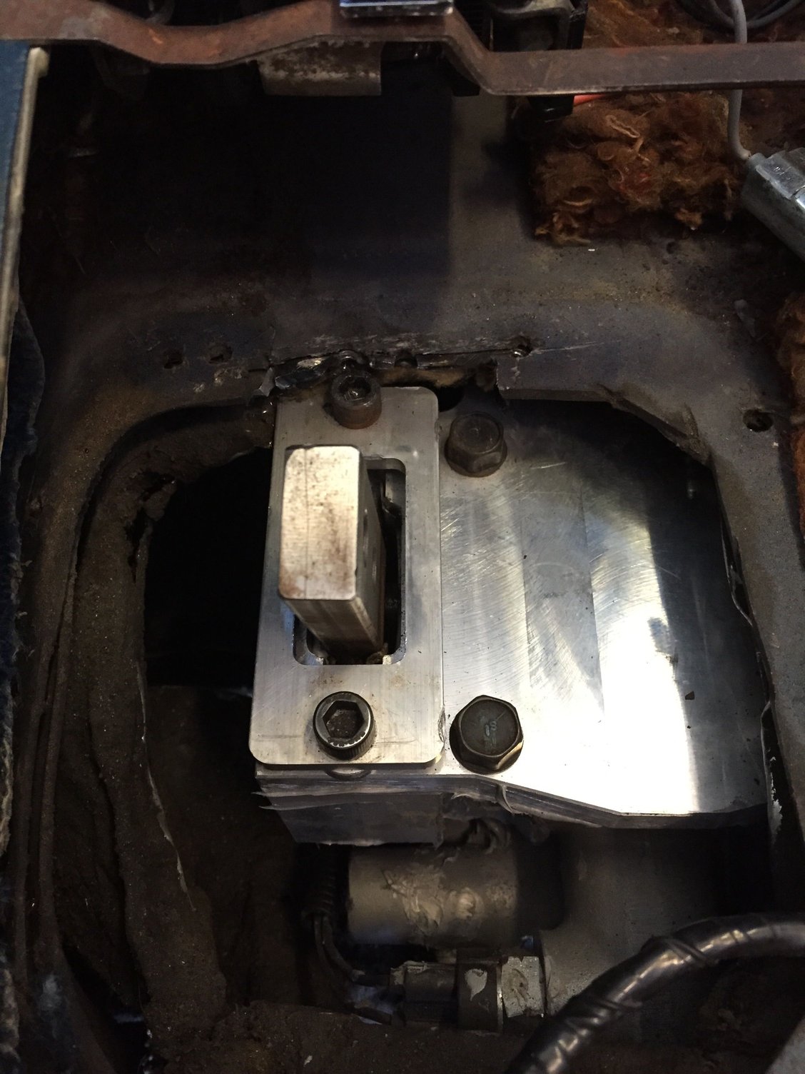

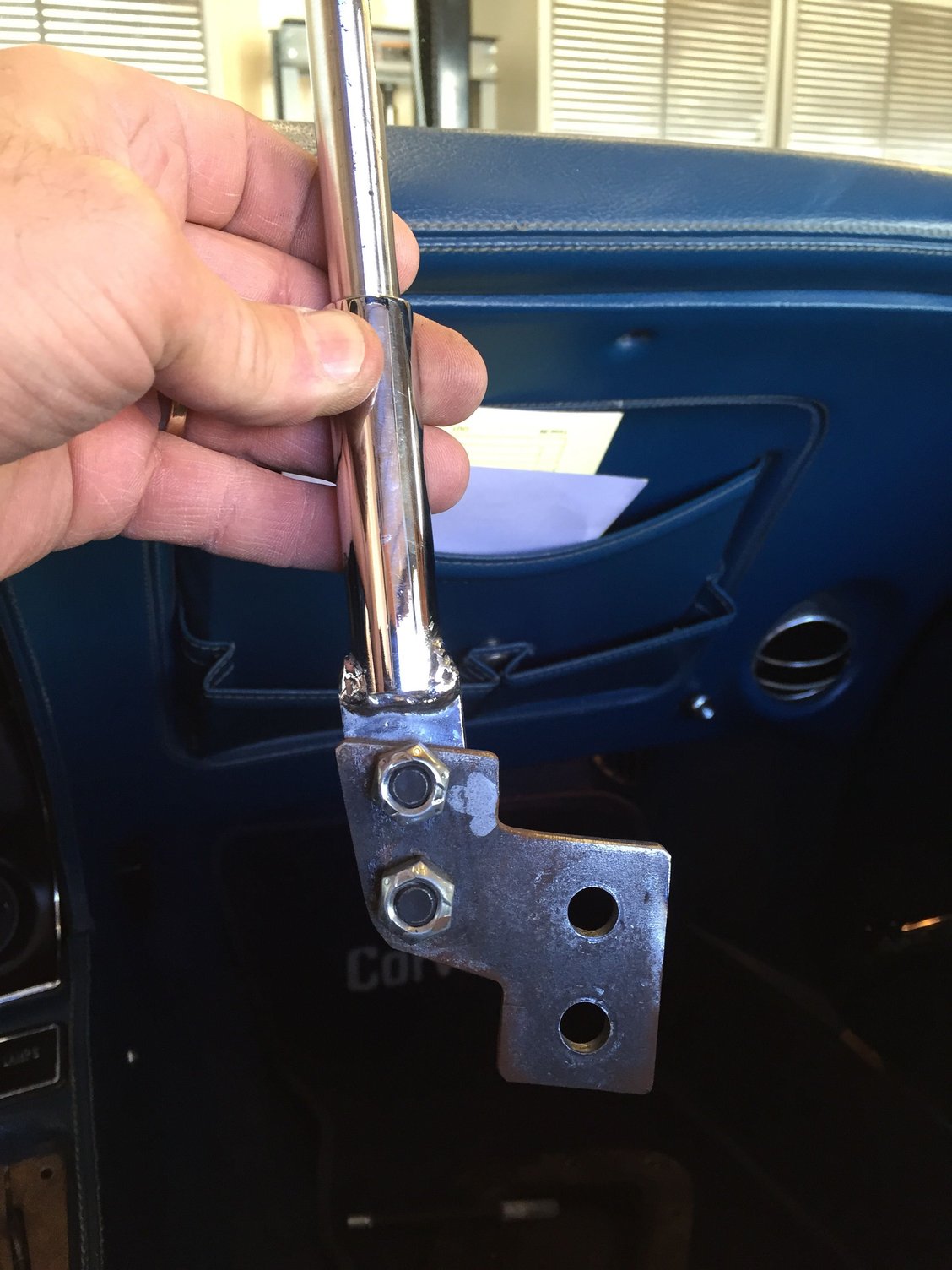

Don't think yours is for a c3 corvette unless you have a really offset shifter. Here is mine. PM me an email address and I can send a video of the slop.

I was showing you how a "regular" TKO shifter looks. I took that one and modified it to work with a TR6060. Looking at your shifter, it may be the problem. Other TKO C3 shifters look like this one Richard had.
https://www.corvetteforum.com/forums...3-shifter.html
Yours will probably not work with a "regular" style shifter unless you replaced the shifter rail with regular parts. It looks a lot like this one.
http://xtremecarzone.com.au/index.php?showtopic=702
That thing just doesn't look like it is engineered well, at least to me.
It still has a bushing, (maybe two with the conversion), and to me would still be worth looking at.
