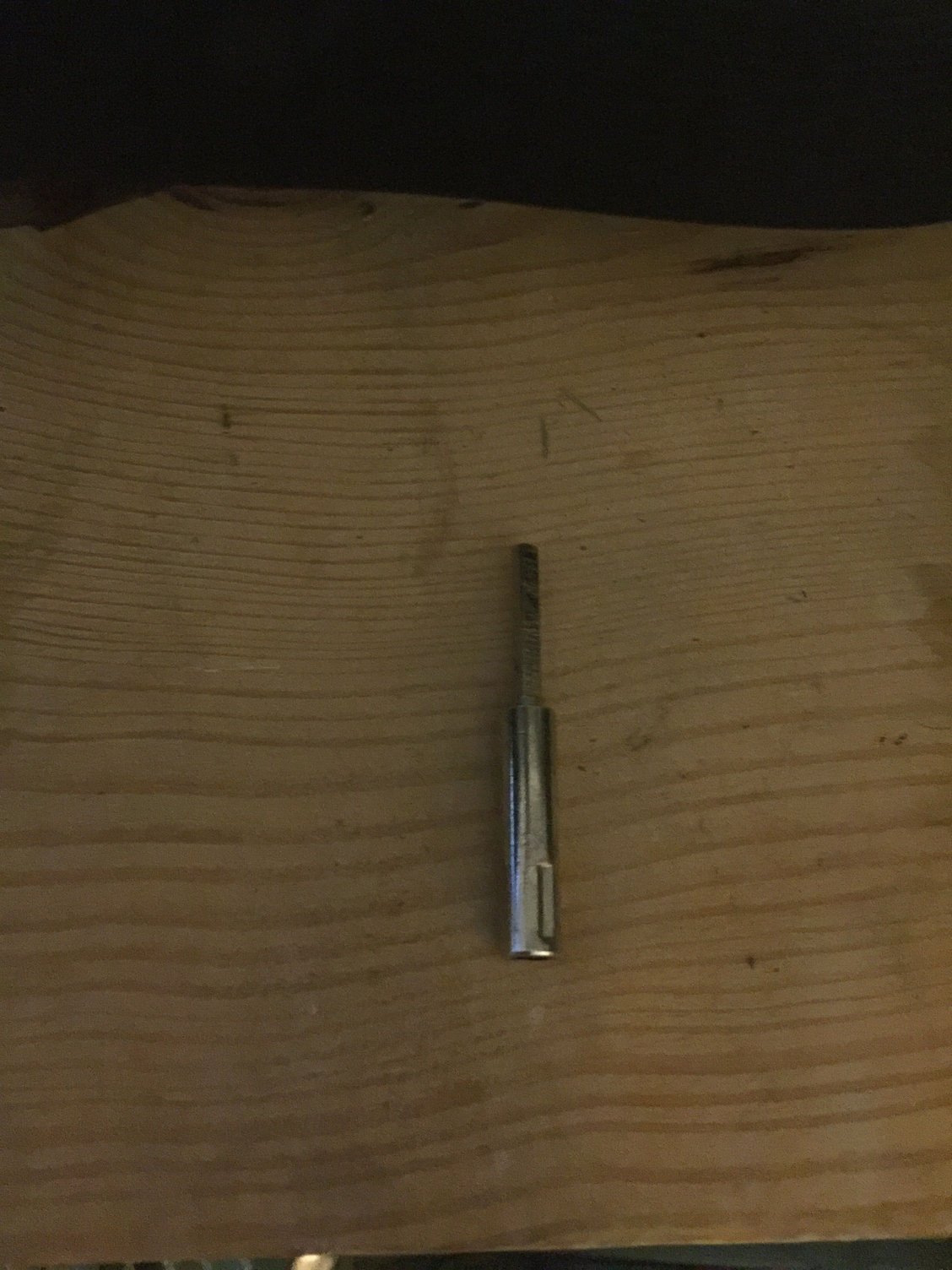

All you need is this adapter. I forget what it's called or where I got it but you will see if you look through my posts.
