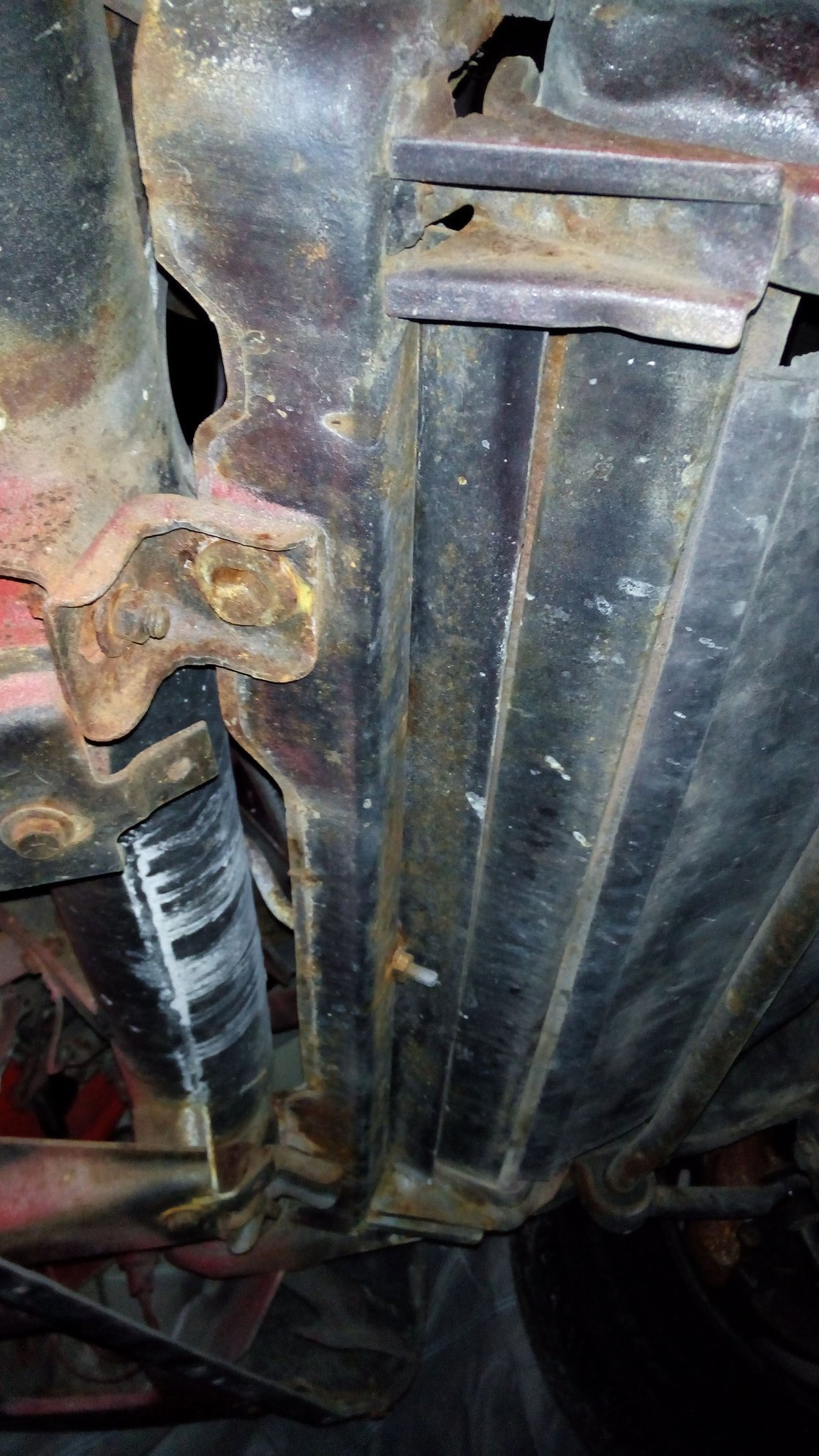

Okay so I checked the trim tagged and it was thickely painted over so its hard to take a picture of it but I got to read this:
Chevrolet 031
Trim 192
10L paint
Here are the pics for the rad core support and the top of the rad (she is really really dirty and I havent had a chance to clean her up)
Bottom rad support
Top pic

Definitely looks like the early-type to me. The triangular pieces under the cradles shown in his bottom pic are not present on the late-type support since the late-type has the long baffle for the radiator to sit on. The early-type only had the 2 little cradles.
The trim-tag info decodes as follows:
O31 - doesn't make sense... I don't believe O was ever used. Letters A-L were used. A was August of 75, when the production year started, up through L which would have been July of 76. It's probably C31, which would be October 31st. Can you try to chip the paint off and confirm this part? The tag is aluminum so you don't have to worry about it rusting if you chip off the paint: just use something that wont scratch the metal too badly.
Trim 192 - Deluxe Black leather interior, so you would have had leather seats, cut-pile carpet and carpet panels on the doors, as well as Teak wood inserts in the doors and shifter console panel.

The way to identify the first design support, from the second design, is to look at how the bottom of the shroud is attached.
On the first design support, the shroud attaches to studs on the two lower radiator saddles. On the second design support, the shroud clips into a tray that runs the length of the bottom of the support.

Take a look at the last 2 photos here. The early 76 has the triangular gussets supporting the bottom of the mounts on each side: the late type does not. His picture above clearly shows the gussets, ergo he has an early-type core support in his car. This would be corroborated by the trim tag if he gets back to us with a good photo of it, or can confirm it's a C, not an O.
I think the 'tray' everyone is seeing is actually just the bottom of the radiator.

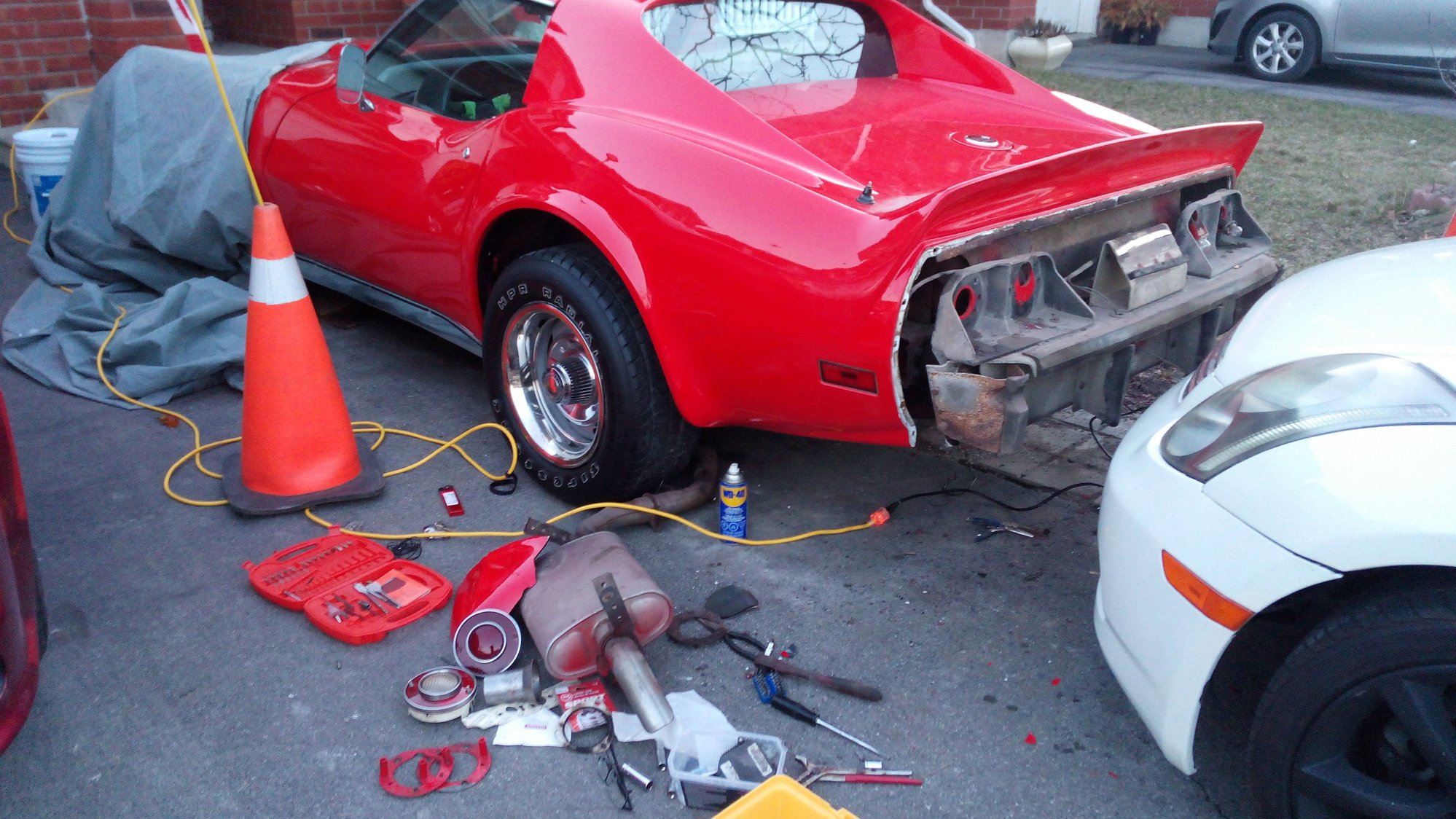

I will get back to you guys tomorrow or friday with the vin number and the tag number, I just finished tearing the rear bumper out today, was a pain in the *** cuz the three bolts that are behind the brake lights had too much rust, had to drill them through. You guys know where to get a rear bumper bolt and nut kit? Along with the brackets?
The old bumper was dry and cracked, got a used one that will be going in here soon

corvette114, based on the information and pictures you have provided, your car came from the factory with an early-type core support, and that is also what you currently have in there. It's probably the original part, even. As to your original query about which radiator is best, a lot of people here like Dewitts but it's probably out of your budget. I've read good things about Champion as well.
