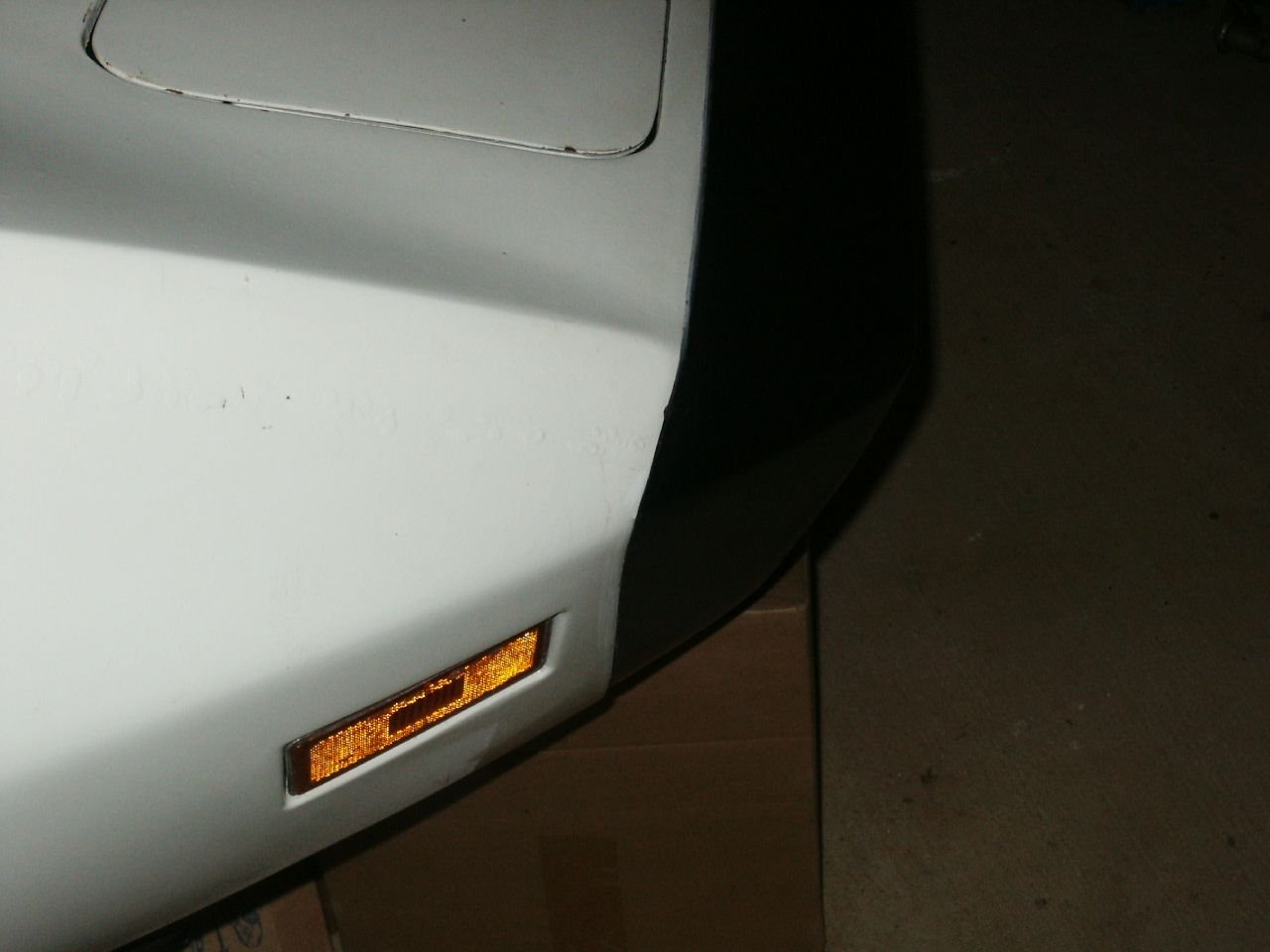

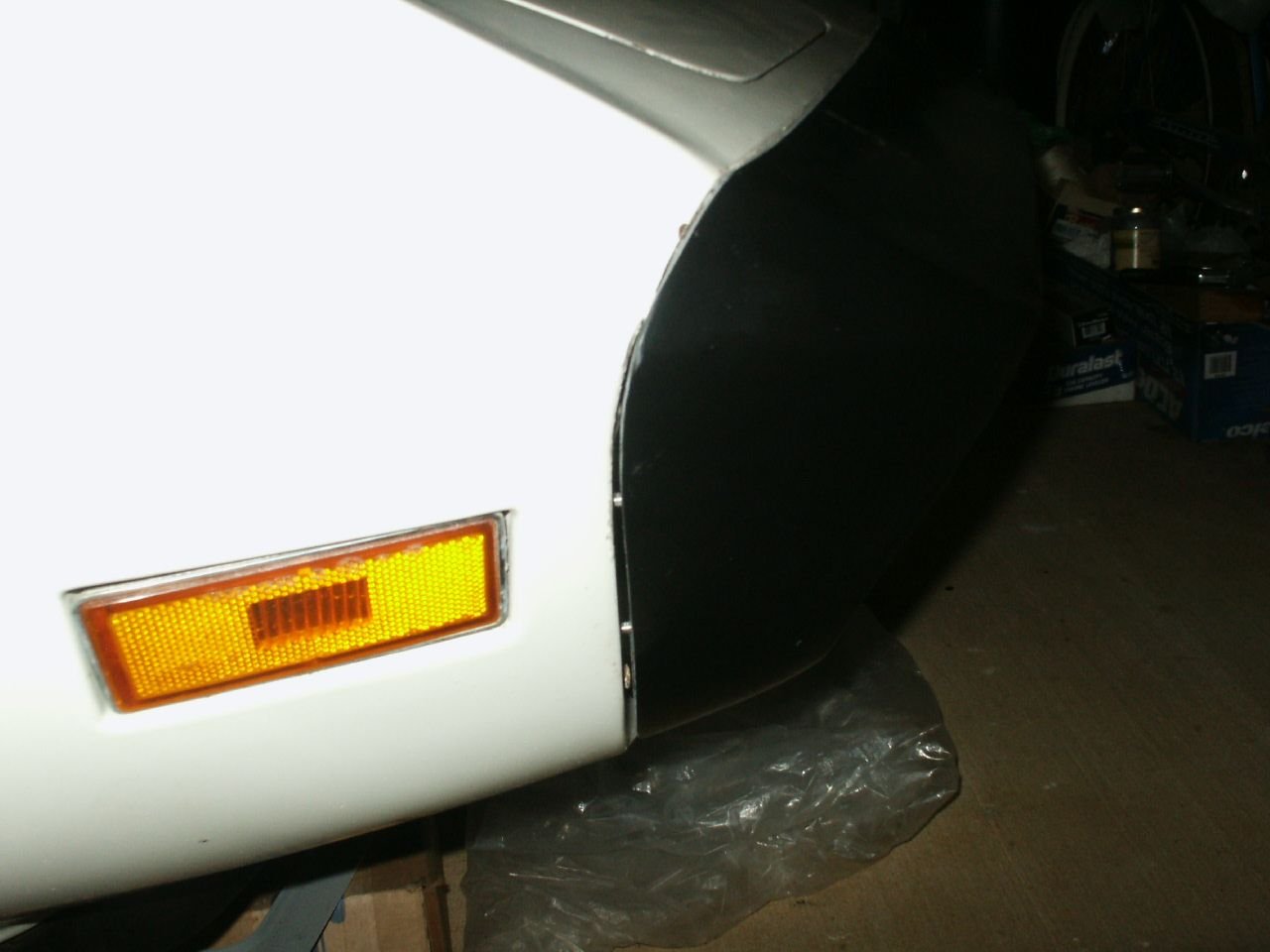

I replaced the front bumper on my 73 with the Tru-flex from Willcox.
The fit was not perfect, but it took just a little work to make it fit. I didn't
remove any of the front bumper parts and even left the rubber piece
that runs across the front of the main bumper support.
I have not painted it yet, but am happy with the fit.
Drivers side:
Passenger side before work:
Passenger side after work:
Donnie

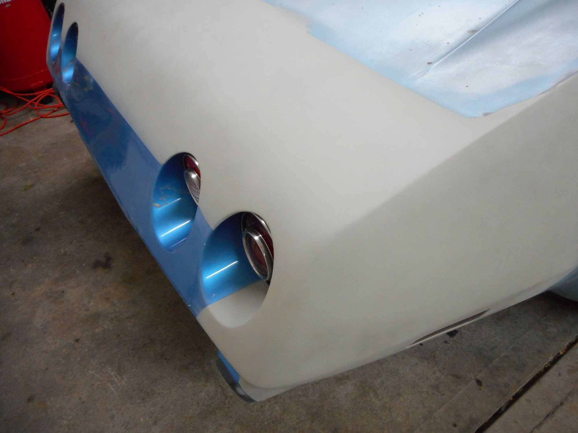

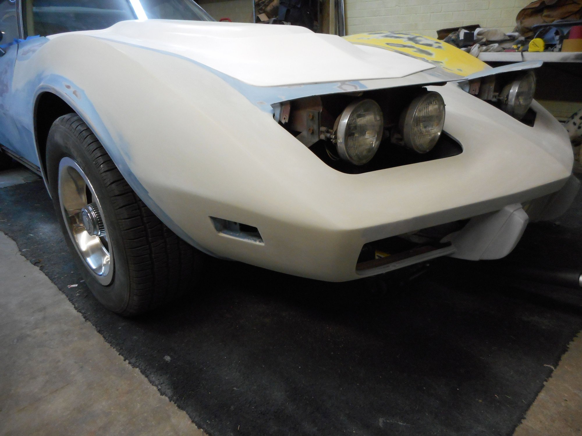

I used a new front glass bumper from Ecklers and the rear glass bumper I bought off CL. I had them glassed to the body.

DonnieP73,
Are we to assume you did the work...........thanks for posting photos.
gjohnson
That looks like a great fit, I wonder how many hours of work it took to get it to that point?

Originally Posted by Maymyvetteliveforevr
DonnieP73,
Yes, I did the work myself. Just needed to grind down the high
areas (on the bumper not the body) and then reinforced the backside of the flange where
I removed the material.
Donnie
