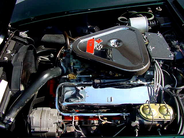

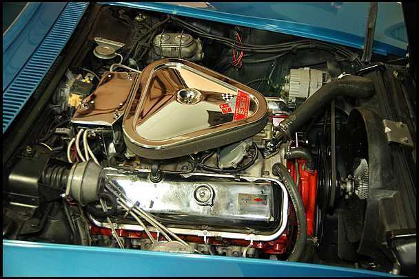

Does it look like this?

Why no over flow tank???

Big mistakes on that one. Rad cap is on a small block rad as big blocks had the cap on the tank and none on the rad. The top fitting is a welded 90 degree that looks like it came from fleabay or Champion. Look at the ignition wiring with blank posts on the valve covers and the wires run behind and down like a small block.... Great example....

The top picture kid vette posted is a 68. The lower is a 69.
68 435HP radiators were direct fill and had the fill cap on the radiator. The radiators expansion capacity was built into the end tank.
69 435HP radiators did not have built in expansion capacity and a separate expansion tank was used. The radiator itself didn't have a cap and was filled through the expansion tank.
