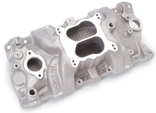

I ordered the 7104 performer RPM intake.
I'll see how it goes with the stock Q-Jet for now.
I can always look at switching to a holley later if the q-jet doesn't work out.
I will probably need to get a drop base air cleaner to get it to fit.

That spreadbore intake you bought is really qjet only imo.
im a huge fan of holley but havent had good luck with the 4165/4175 that are spreadbore. ymmv.
You absolutely do not want to use adapter plates to go to squarebore.. Theyre terrible. Again... my opinion...
I agree 1000% with commander on his carb recommendations on this post and others ive seen. If it were me, I would go squarebore rpm and holley 4150 ultra street avenger 670. Its what I just did. in the mail now!

That manifold is q-junk only without an adaptor plate.
You will be limiting yourself in Carb choices unless you use a square bore. Square bore is much better.

I know Lars has a few Q-Jet papers out. I'll look into those and see how I can go about tuning the stock carb for this combo.
Also, I do already have the 7101 Square bore Performer RPM. It's bolted to my Camaro with a holley carb. The 350 in the Camaro is pretty much stock, so I can swap that intake out if need be to run a Holley on my vette later.

I've run this exact manifold with both a QJet and a 4150 Holley - on a 383 and a 406 - and it works very well either way. Other suggestions to the contrary are not accurate, based on my experience.
Old May 17, 2015 | 05:52 PM
Domobomb's Avatar
Domobomb
Joined: Jan 2012
Posts: 321
Likes: 16
From: Ontario
Great, thanks for the info.
