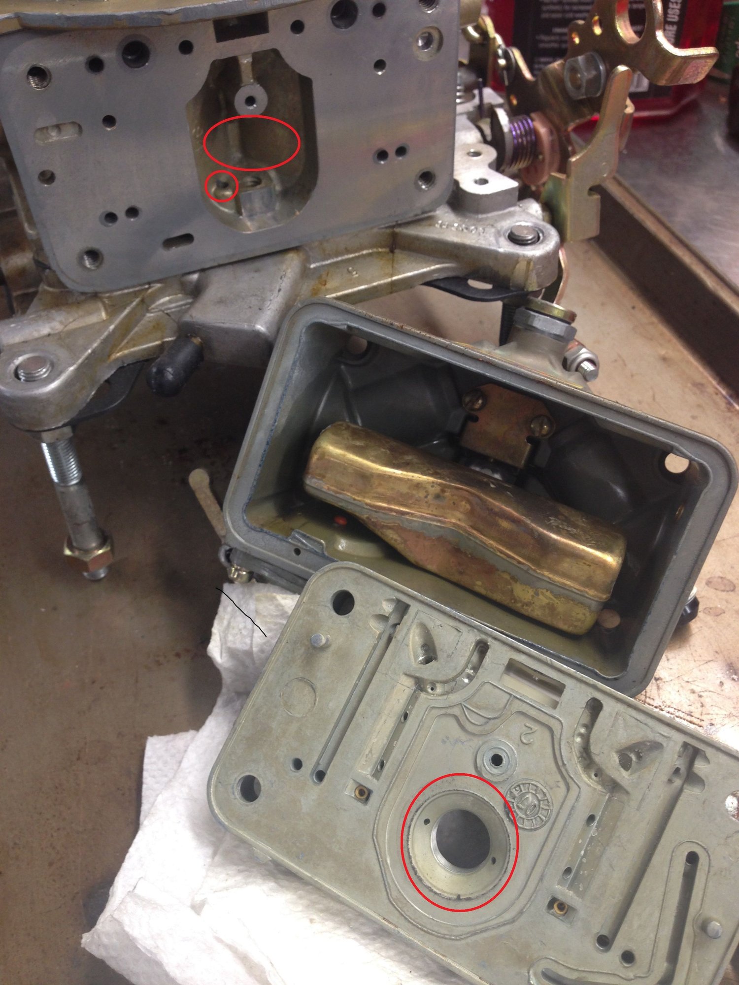

A ruptured or damaged diaphragm in the power valve WILL cause fuel to run into the engine both while running and after shutting it off. Trying to start up right after getting gas or being off for a short period time and the thing starts like its flooded.
This also leads to engine that runs really fat and you get popping from the exhaust almost all the time from un-burned fuel. Greate article on Holleys http://www.hotrod.com/how-to/engine/...-basics-guide/
The ethanol content in our gas today (not E85) is like 9-10%. If the car sits alot like these tend to the gas evaporates quick due to the ethanol and then reeks havoc on rubber. My fuel pump diaphragm was shot and my accelerator pumps as well as my powervalve. Edelbrock tech told me to run Marvel mystery oil in the gas to keep oil on the rubber of my 1722 fuel pump so it doesn't dry out from sitting. Your needle and seats could also be eaten up.
I know because I just went through it. If the power valve is compromised it will leak fuel all the time until the bowl empties out. You cannot see it leaking because it leaks right through the base plate via the vacuum signal port NOT through the venturi or boosters.
I have pen light under the power valve and you can clearly see the light shining through the diaphragm in both pictures below. 3 out of the 4 windows in the power valve shown light.
The smallest of the red circles shows where the power valve gets its vacuum signal from in the main body through the base plate. If the power valve is compromised it will leak fuel all the time until the bowl empties out. Running rich and flooding the engine after being shut off. The bigger circles show where the powervalve is located in the metering plate and main body incase ur unfamilar.
Accelerator pumps are shot (wish i kept pics of my fuel pump diaphragm to show you guys.
