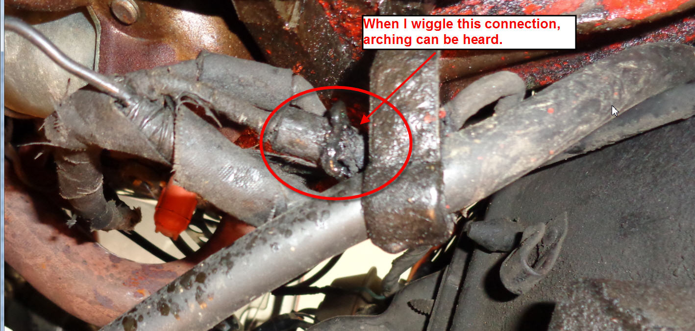

I checked the easy stuff first -- the battery is fine and the ground cable looked good to. I next put the right side of the car up on jack stands so I could examine the wiring around the starter. When I wiggle the wiring under there, arching can be heard. See the pic that shows the bad wire/connection. Question to the forum: is this a fusible link or is this simply a connector?
Unwrap it and see what's going on. That is a very hostile area because of heat and water so it's likely you have a real bad connection.

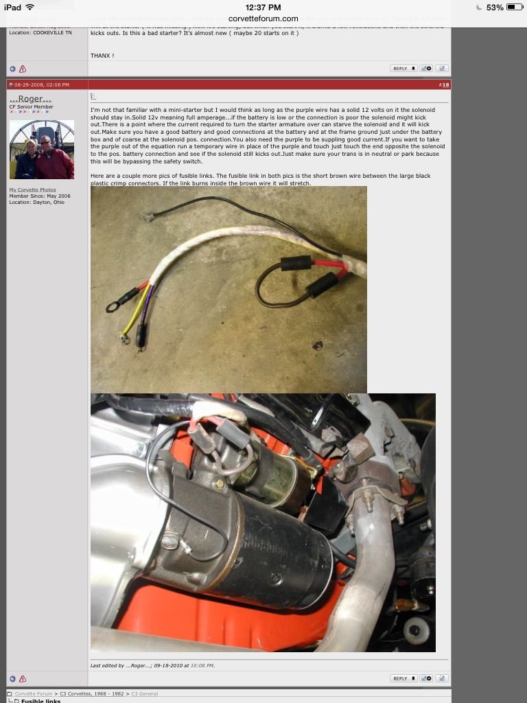

Good call Chinaski. I agree that I need to determine if that is a fusible link or not. This is such a melted mess that I can't tell. Does anyone know if there is supposed to be fusible link around the starter?
Had same problem,hope pic helps, remember it's special wire. It's the wiring between the barrel splices, needs to be proper gauge and length
It's 14 ga at stater link

Sounds like it worked, but I don't like the idea of using same link, they are designed to fail and yours was compromised already, I strongly suggest new wiring, if you can't find any I have plenty, if you p.m. Me I'll be happy to send you section.
