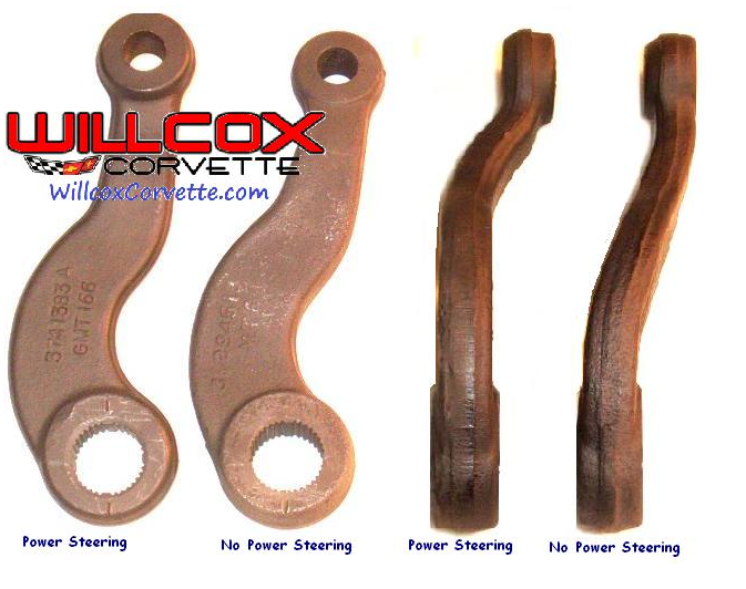

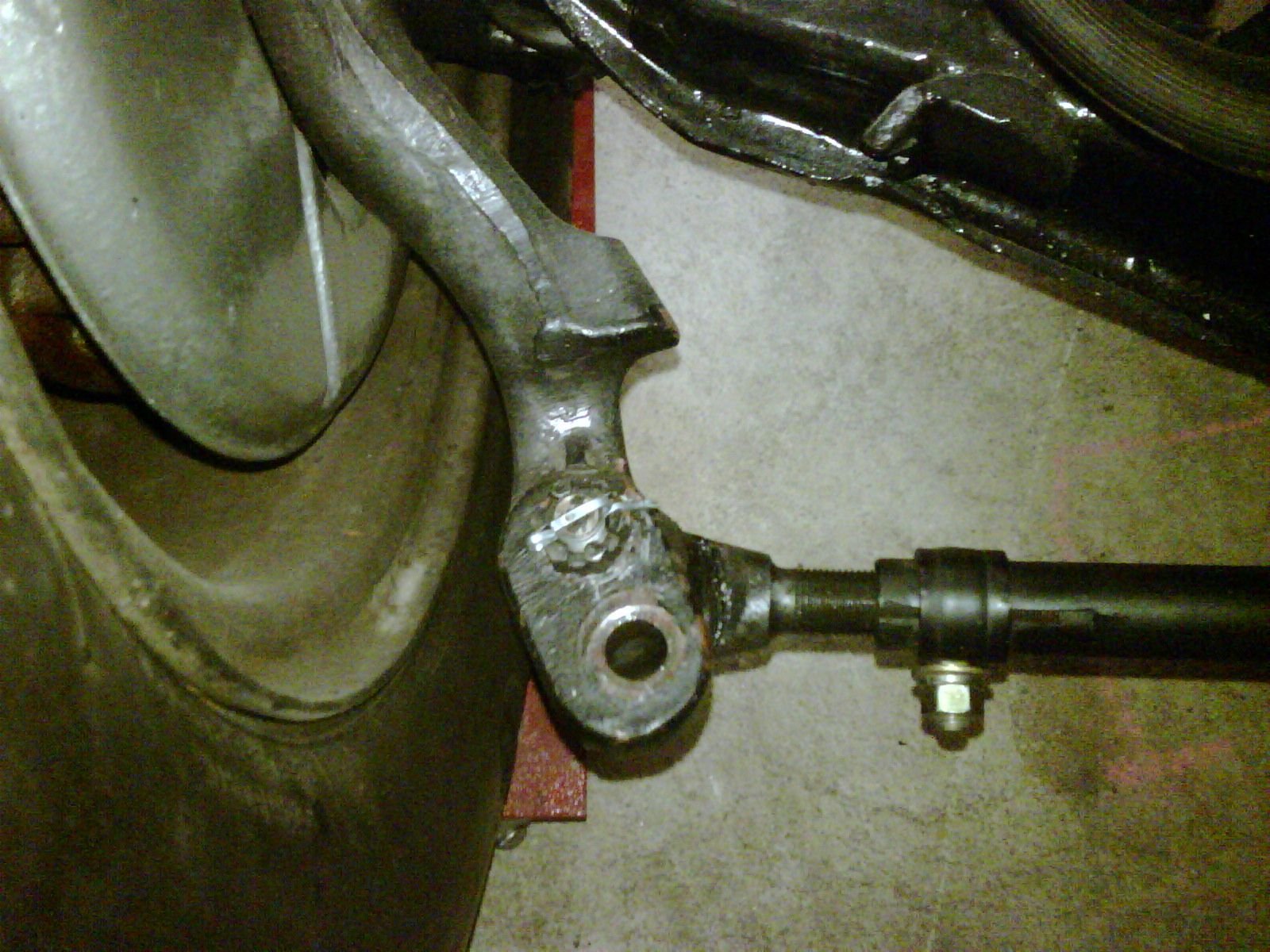

Almost sounds like you have either the wrong pitman arm (manual steering pitman arm on a power steering car) or you have put the tie rods into the wrong holes on the spindles. For power steering you want the tie rods in the holes towards the front of the car NOT the rear.
