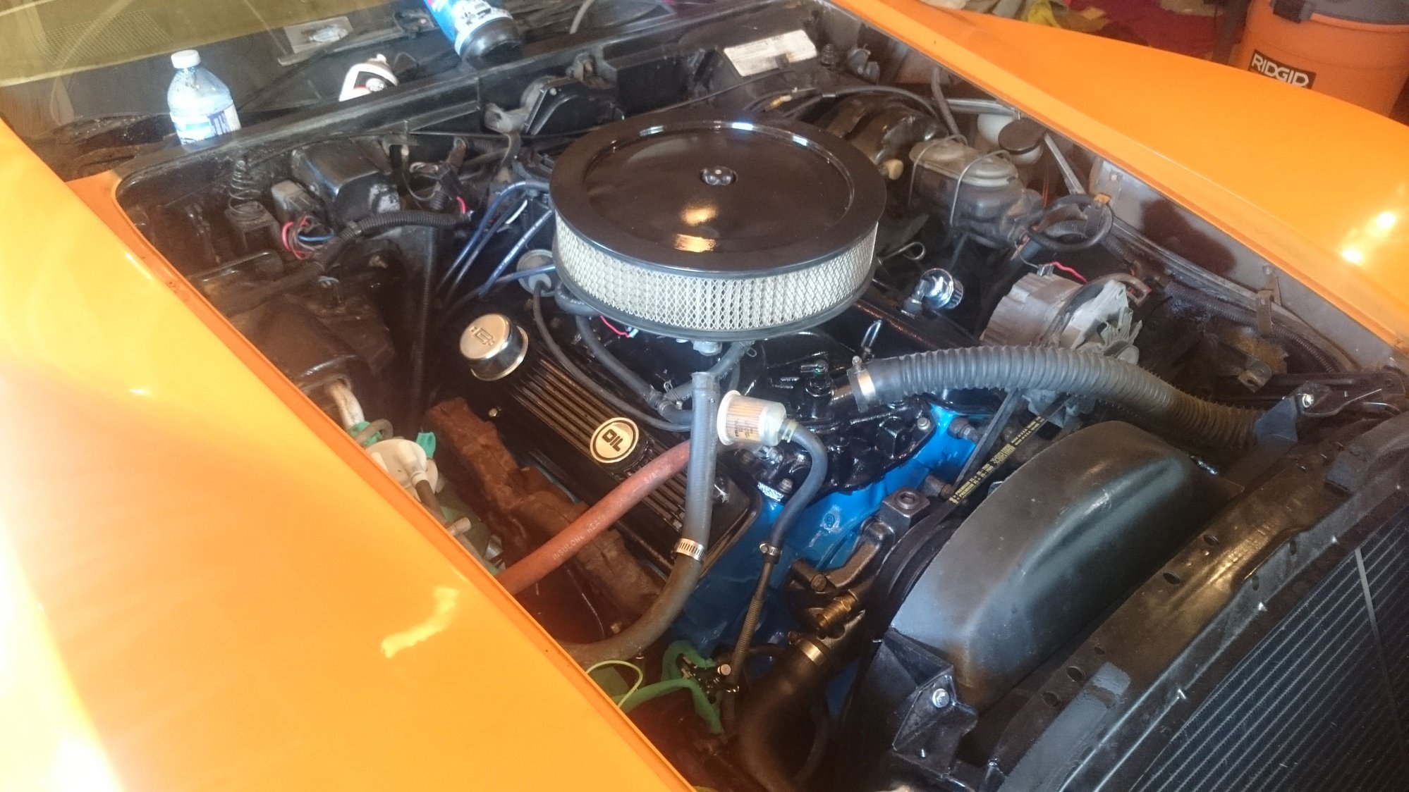

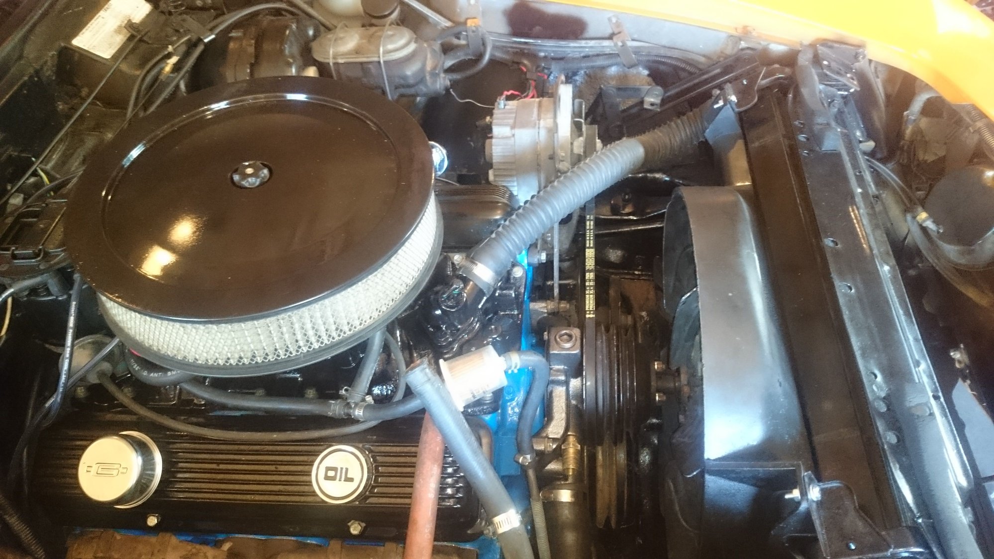

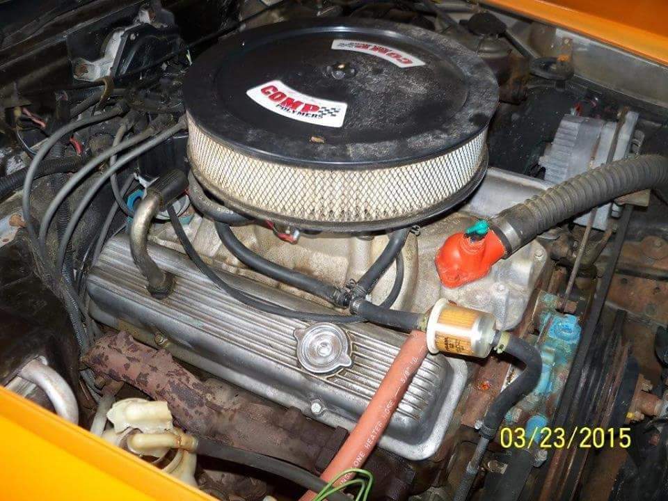

All most there.
New engine more boom. Need to still install u joint. Ground starter.(yeah yeah i know) fuel leak small. Set distributor.
Pulling old one out.
Old engine orig l82
