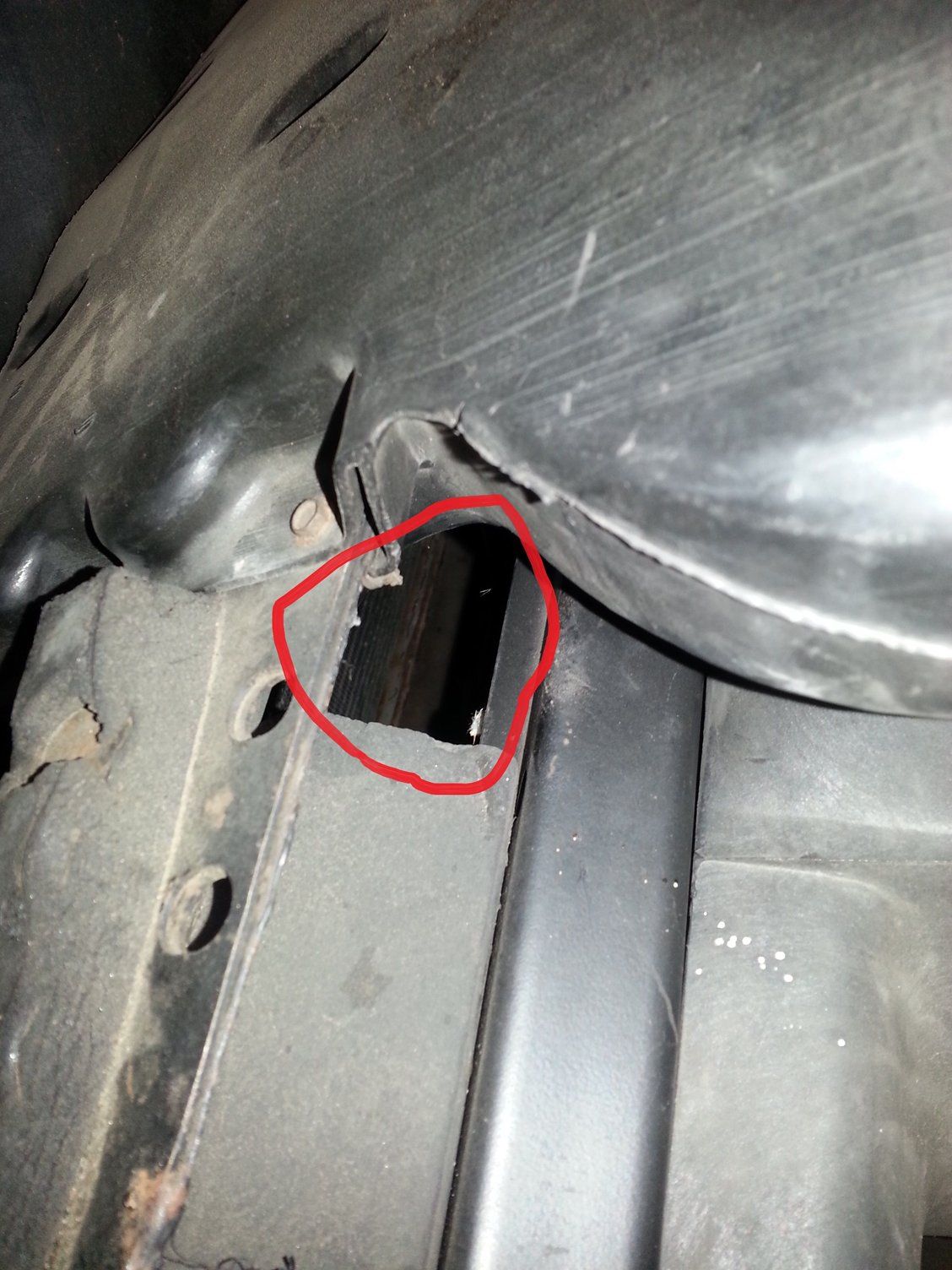

My '77 L-48 heats up as I drive 20 miles to work. While working on changing the advance weights on the distributor I noticed an area where I think there should be a seal between the condenser and the radiator.
Under air intake

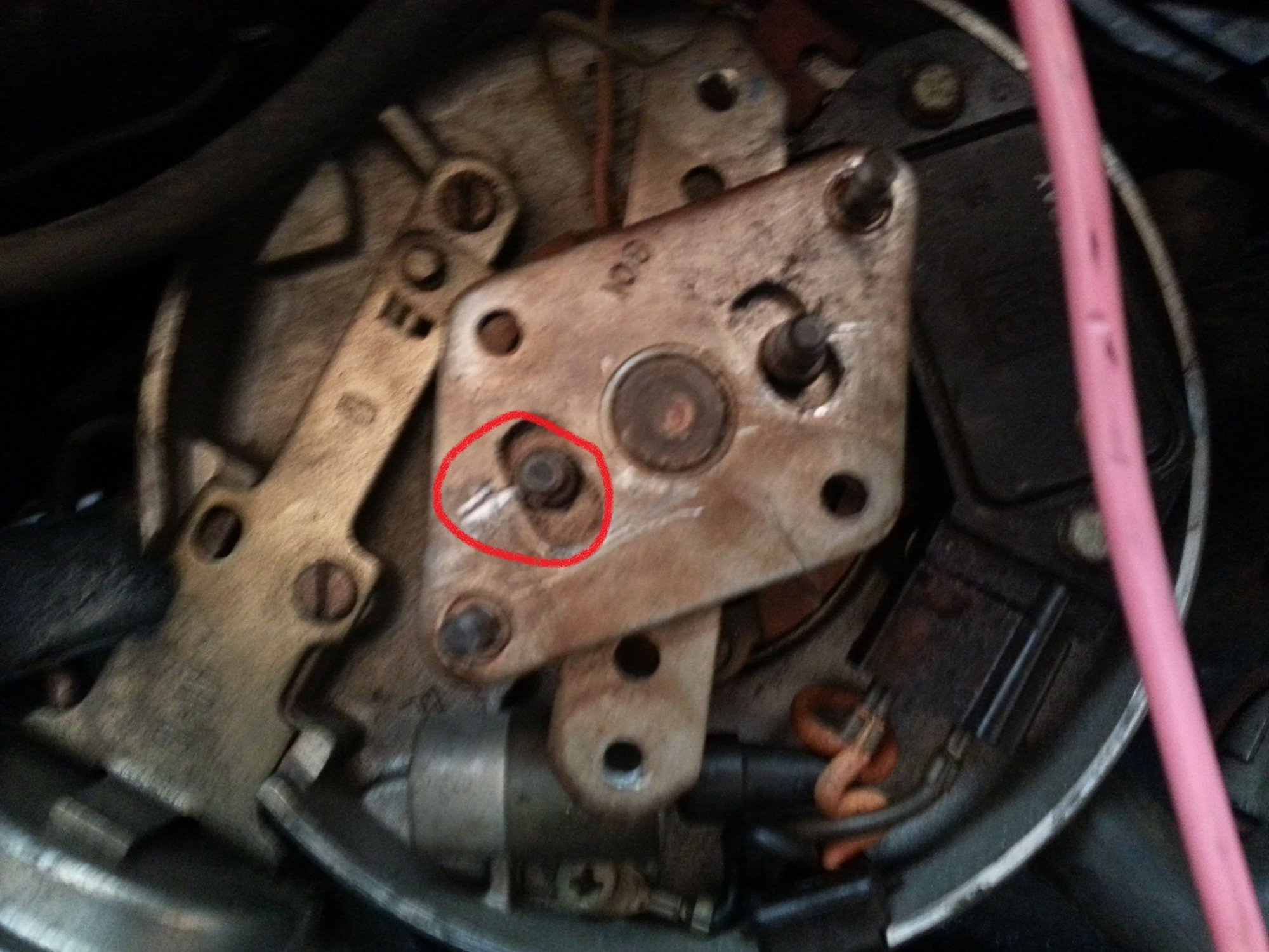

While removing the center plate I broke one of the posts, do I need a replacement distributor now?
Broken post.

No, you just need to rebuild that one

that is welded pivot stud on the main shaft of the distributer,
it would require, removal and full disassemble,
and then not sure where you could buy a pivot stud and get welded.
for a 77 Dist. I would just replace the dist. it is nothing special, standard HEI dist.
good luck...

Timing changes can effect running temp. Still that's assuming you have been messing with your advance before the stud broke. If not it could be a thousand things and I'd start with the basics, clean the rad or ac condenser or maybe new fluid.
I'm missing that whole insulation strip! it's on my list to replace the insulation, but my car only goes up to 180-190 in hot weather and it's been cruising kinda lean & running out of fuel after I made some exhaust and suspension changes. I want to upgrade my fuel pump & some other stuff before I start to retune. I also have really under driven my water pump and fan pulley and once I replace the insulation I'll try a bit more under drive. So I don't think that little section is gonna cure your problem.
Also what is "heats up" in temperature?
edit: My car runs cooler than most just FYI, my point was many things can make a car run cooler or hotter.

New post, not gonna edit again LOL
Anyways looking at your pic reminded me of when I removed my air-intake duct on my 77 and how it went thru that area somewhere. That made me realize I couldn't buy the seal kit for my year and then I looked for a compatible year. Long story short I found others use round pipe insulation and it's much cheaper and will work perfect for me and prob would be a cheap and easy thing to try for yours.
So thx for the pic and jogging my memory!

the pivot is not a separate part, you replace the complete shaft, see link below
https://willcoxcorvette.com/corvette...haft-l48-75-80
Holy crap they're not very inexpensive, huh? About the same cost as a rebuilt distributor.
Wow talk about over priced!
I'd buy any mech advance junkyard/c-list HEI and steel the shaft from that one 1st!

You might be able to get by with just the one distributor spring post. Two weights and two springs will exert the same force as one weight and one spring. The only difference is that one spring may not be forceful enough to return the distributor to zero degrees advance when the engine slows-once the engine revs, the centripetal advance may remain maxed out. Install one weight and spring only (use grease on the post so you don't break the other one also). Run the engine to determine your advance curve.

Thanks, I ordered a replacement HEI unit as the cost of that shaft is awful high. Who know what else might be worn out.
