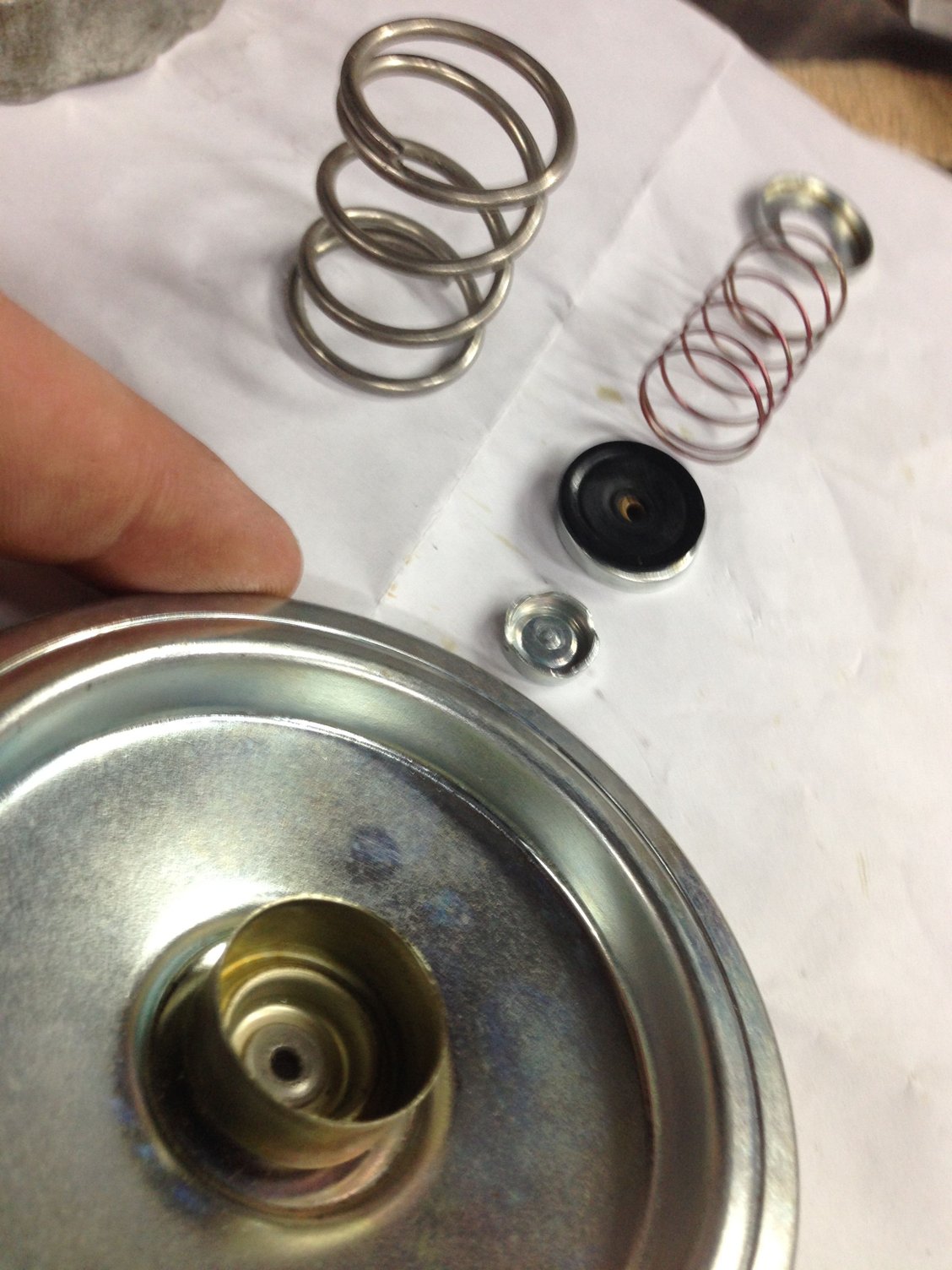

Originally Posted by bashcraft
Neither your gas tank or cap are vented. One of them needs to be.
My 69 has a vented cap (69 did NOT have the EVAP system). Not sure which year started with the NON vented cap but you defeated the EVAP system on your car blocking that off so you now have no vent. That charcoal (emissions) system is to trap the fuel vapors from going to atmosphere and be burned up via the hose that goes to the carb from the canister.
As BASH said ... you need one of them. Simplest at this point is to get a vented cap if blocked the EVAP stuff off at the tank.
I had to defeat the seal/spring in my NEW vented cap (I dont think it was made properly) as it was not venting like it should...I pulled the cap apart and removed the rubber seal (look at my pic... there was no way that cap would vent a reasonable pressure with the way that rubber was being smashed by the spring and valve seat). I would come back from a ride and hear hissing... pulled the cap and it almost blew outa my hand. The tank gets warm from the engine and exhaust heat and the sloshing around builds up vapors.
I have no issues with gas smell or cap leaking. These old vented cars always have some slight gas smell to them but mostly on hot days or right after a ride as the heat bleeds off.
