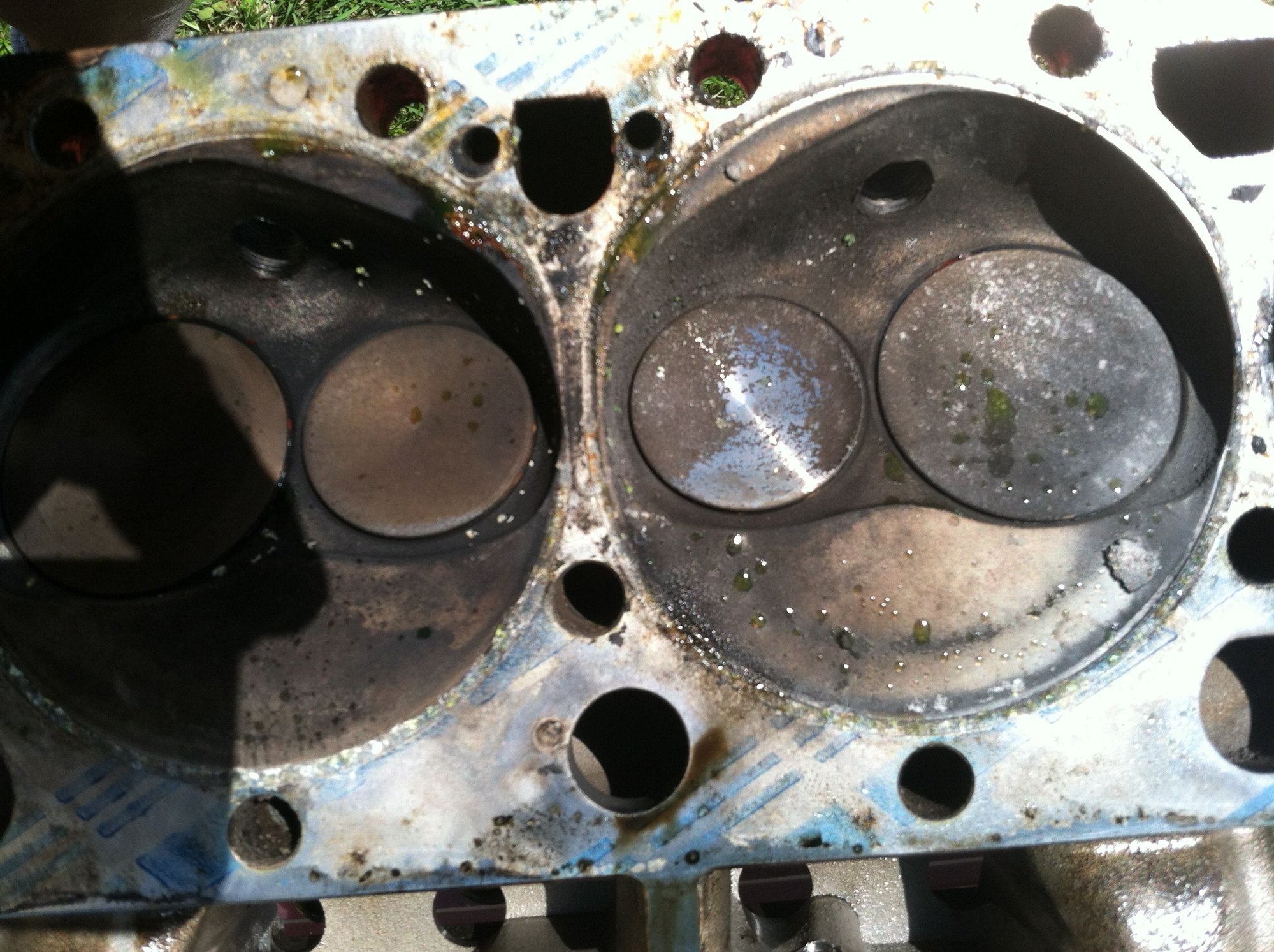

Well this is a add on to my last post. Brand new 383 Stroker myt son overheated it is leaking anti freeze from the head. i am sending pictures of the head and gasket. Hoping it is just the head gasket need some input?

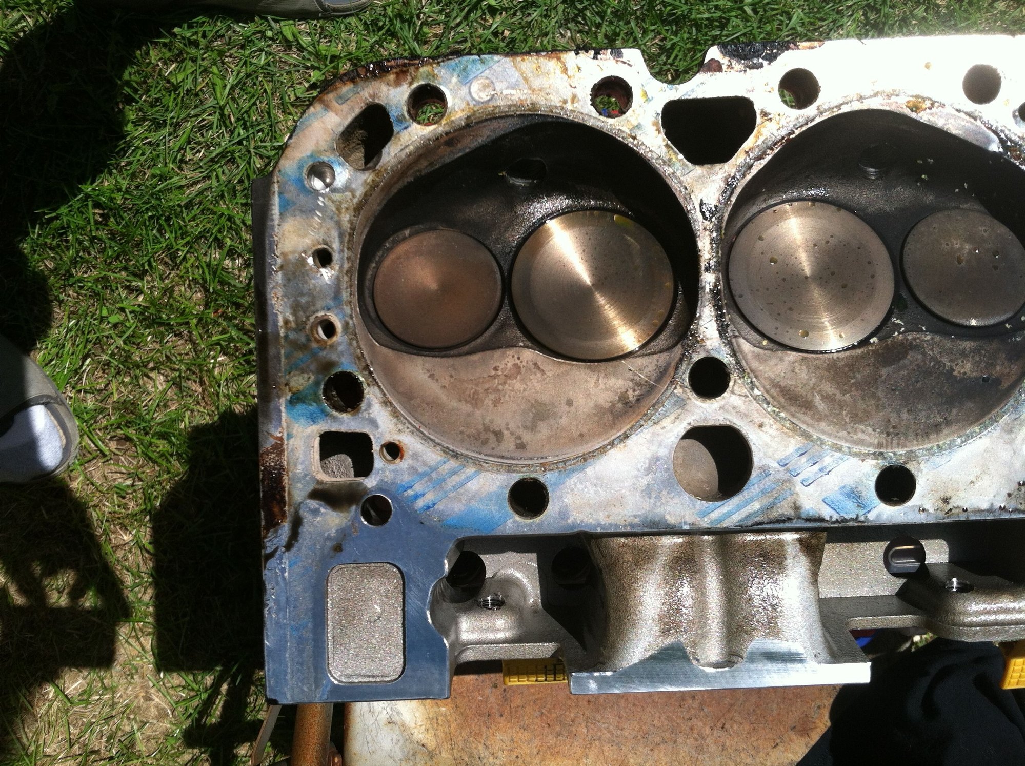

In picture #2 is the piston broken?

In second pic it looks like you're missing part of a piston and there's globs of aluminum in the combustion chambers

Piece of piston missing by the valve reliefs cut into the piston. Mostly likely hydro-locked when coolant got into the cylinder.
Sorry man... this engine is done. Your pistons are .040 which means this is probably this engines third go round. You need to have someone look over those heads real good to make sure they aren't cracked or warped either if you intend to reuse them. The block would have to be magnafluxed / checked for cracks as well... but with 40 over slugs its problably just better to get another long block then reuse any of this stuff.

WOW!!! Sorry, that thing needs some serious professional work. Lots of evidence of detonation... and somebody drove it WAY past gauge and sound warning signs! Sorry for your loss.

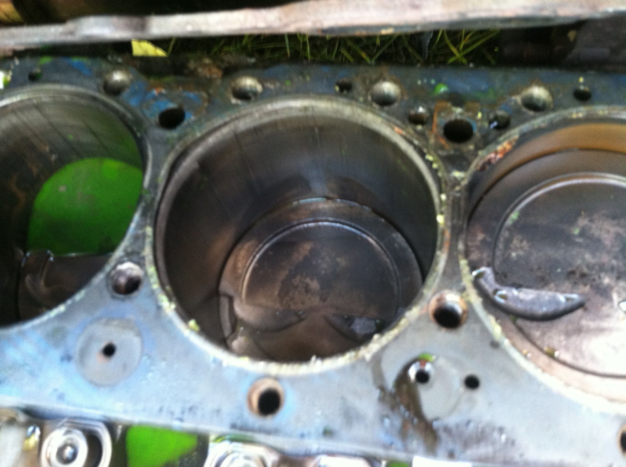

With the existing parts, a complete teardown and inspection first. It looks like a piece of piston has been mashed into the combustion chamber in the last pic. If the heads are aluminum tear them down and have a fluorescent dye check and complete inspection. Basically, this motor is going to need another re-build assuming the heads or block isn't cracked. The pistons are shot and the rods may be too, they'll need to be checked. All the cylinder bores I can see are scored, a hone may clean that up, but may need another overbore.
