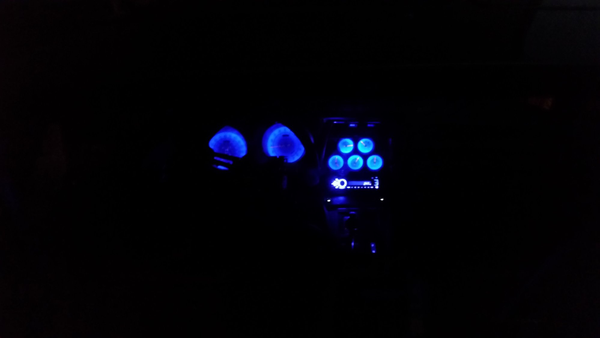

I also changed the reverse lights to LED, as well as all the interior lights, including the dash, which does still dim, although I keep them on the brightest setting.

KrisB410, do you have a list of the LED's you changed out your dash lights with? Not sure what year your Vette is but I have an 80 so my needs may be different anyway, but I really hate how dim my dash lights are and would love to change them to LED's if they remain dimmable. Thx!

I got my dash LEDS on ebay. My buddy did his 79 at the same time, his used 194 bulbs.
