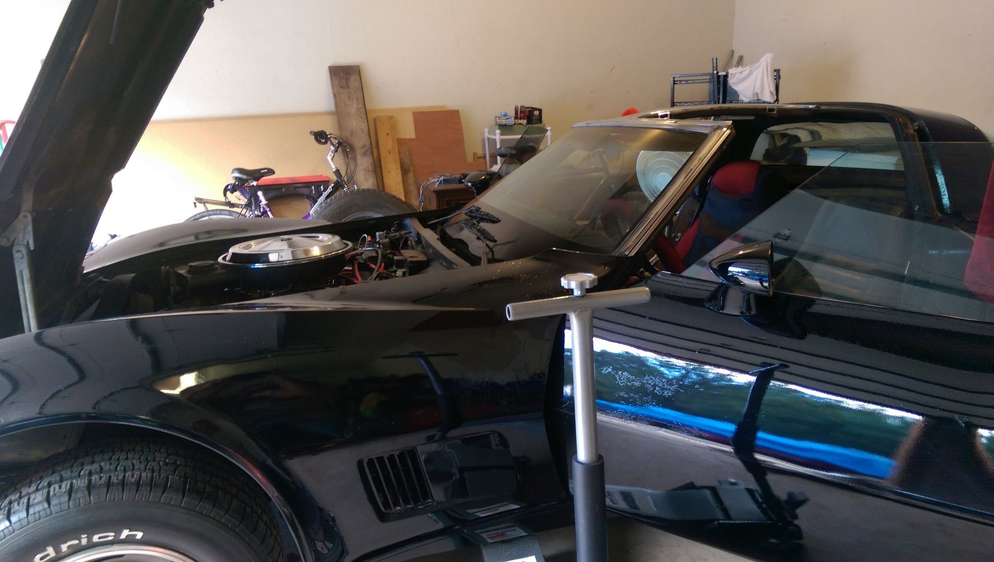

Towed it home. Checked the ground under the chassis leaving the battery compartment already. Checked my fuse box and no power to it?

There was a pile up she's a beauty. So frustrated right now. It should be simple to find I would think. Is there a fusible link before the fuse box? I turn the key nothing no anything.

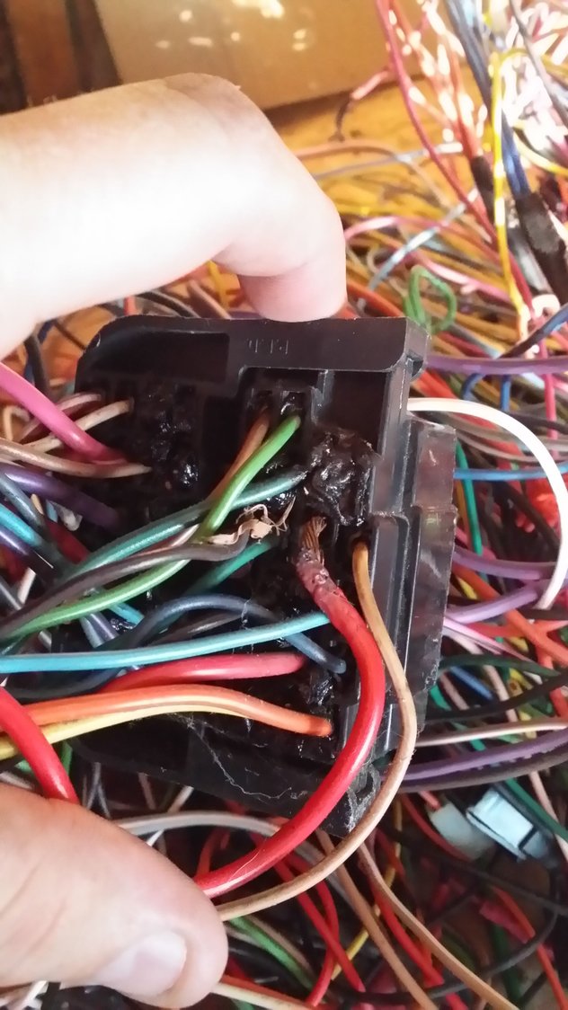

Check the harness where it meets the fuse block at the firewall, mine lost power inside the car due to this.
