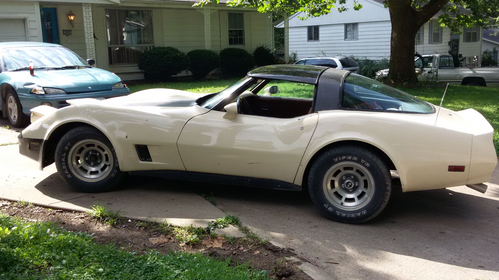

81 vette true duals on bone stock car . First vette
