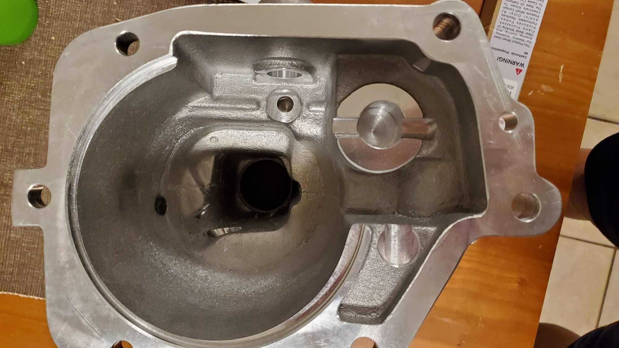

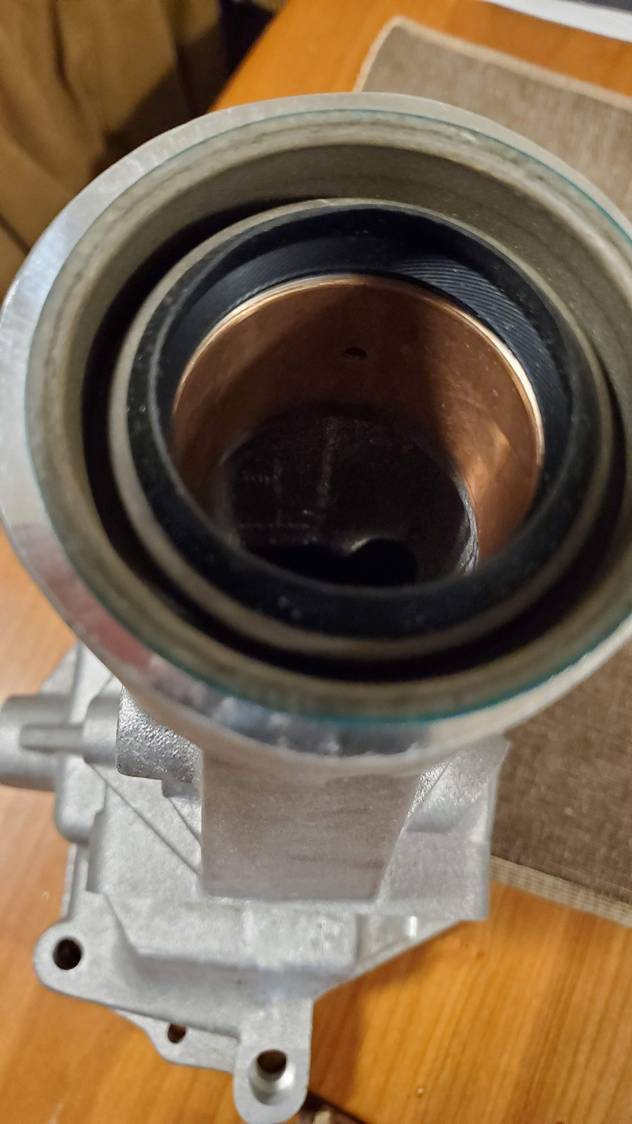

I have spoken with you a few times on the phone and purchased many parts from you and I know this is an old thread but I am curious whether you have any experience in counterfeit tailshaft housings for Muncies being sold as AutoGear parts... I am looking at one now and the casting is very rough however the machining looks on par for AutoGear as I already have their super case and your Iron Midplate but I have my concerns... I'm a member of Steves Nova Site for a few years and was trying to find one of these tailshaft housings for my current '70 build but it appears everyone including (you) SUPER661 / 5Speeds.com is sold out... Any ideas? Or is this just the quality we should expect from now on? I am totally perplexed... Pictures below for reference. Thanks in advance...
~Andy
Rough as can be.... Like a bad sand cast...
