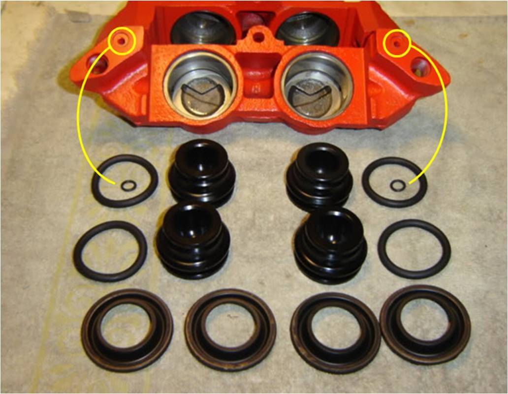

Assuming that 1) the calipers are as new as you mentioned, and 2) that none of the pistons have popped out of their bores or were leaking beforehand, I would just separate the two caliper halves on the workbench and install two new "o-ring" seals (the small ones depicted in the picture below) on the caliper half with the depression around the holes.
Then carefully place the other half of the caliper on top of it and reinstall the two bolts that hold the caliper together. Snug the bolts, but don't bother to torque them until the caliper is mounted on the spindle when it will be much easier to torque them to the proper amount. Be very careful to not introduce any dirt or debris into the open caliper.
As long as none of the pistons popped from their bores and none of them were previously leaking, there should be no reason to replace any other seals. Of course, if any of the pistons are leaking (or you would like to switch them to "O-Ring" seals), this would be a good time to replace the piston seals and dust covers with new ones.
