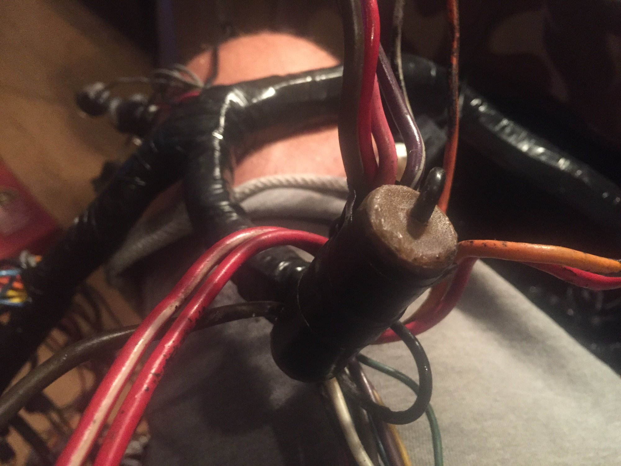

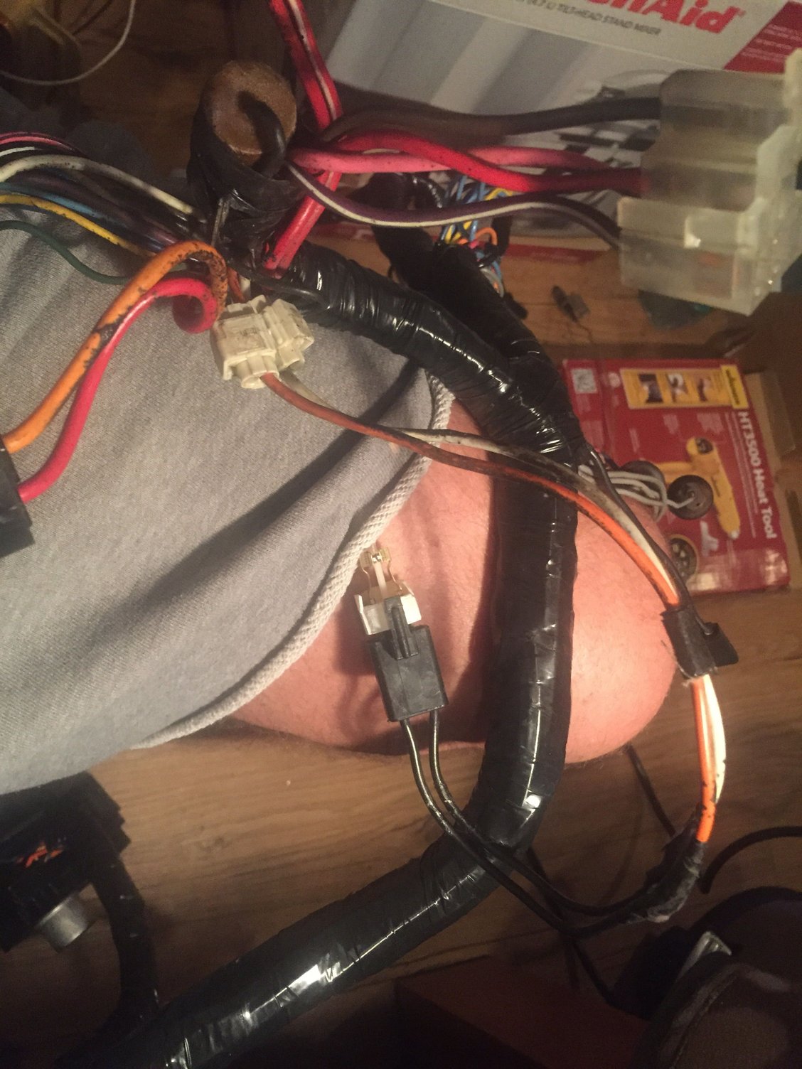

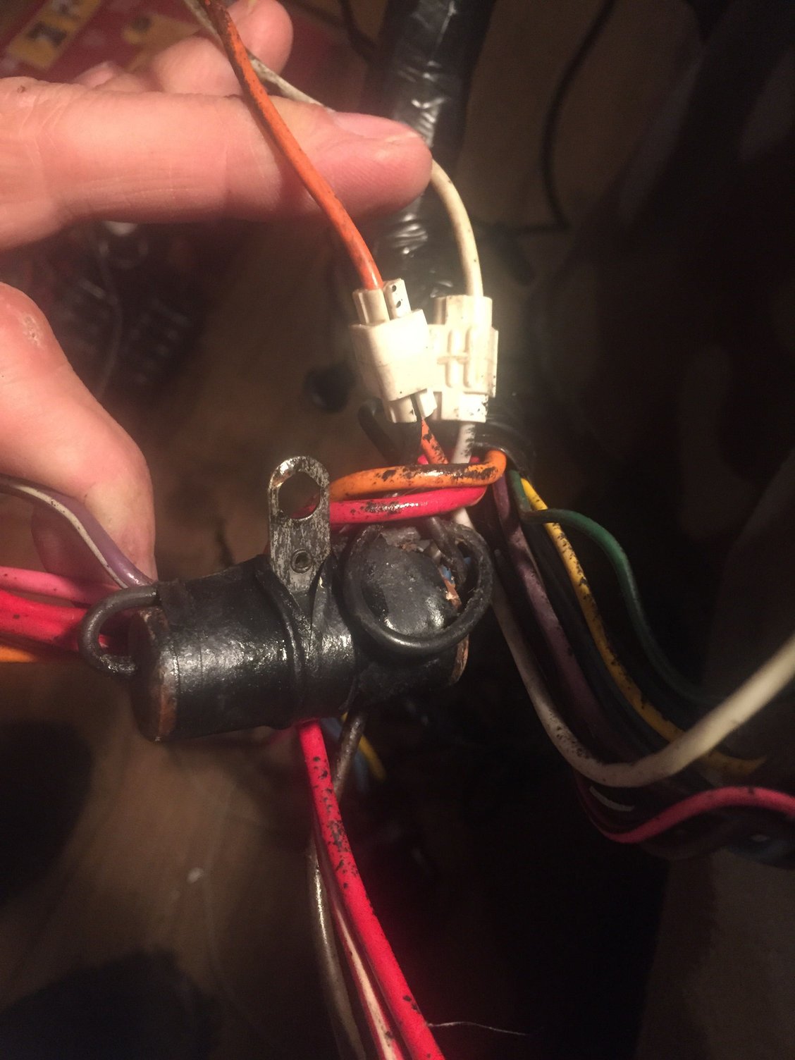

69 early coupe. This is the wiring harness from the fuse box to behind the dash tach/ speedo through radio and shifter. The area in asking about is somewhat centered behind the tach / speedo gauges. The wire in question is whit and orange. I know this plugs into a switch on or around the brake pedal. My question is this. Can you see the suppressor someone put in line? It's spliced into the orange and white wire. Can anybody guess why it's there? Can I remove it ?
I have a 70 vette harness that doesn't have it.
Orange and white wire. Note the white splices.
Just spliced into the orange and white wires

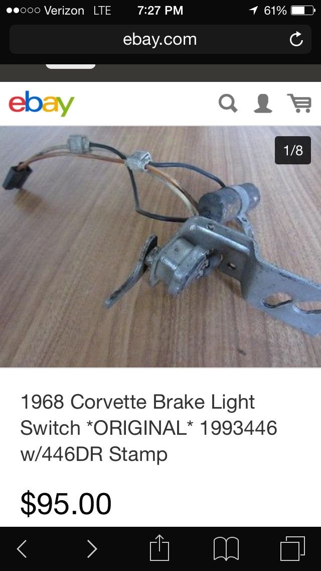

Found this on eBay. Claims its factory? mine looks spliced in the same way. Factory? Idk

Orange and White go to the brake switch. PO was getting a click in the radio whenever he hit the brakes. Leave it or take it out-no difference except you might get the radio noise.

modern radio does not care about this, I would not leave 50 year old capacitors in place.
those old caps can catch on fire.

First off, get rid of those 3m splicers. they are useless.
