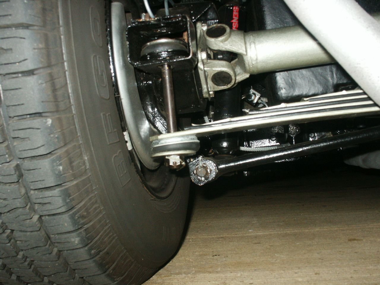

Here you go, this is after more than 2 years.
Donnie

Is your cotter pin completely below the nut rather than being inserted through the castellation slots? Looks like it's tightened up about 1/4" too much. That may have played a part in the early deterioration of the bushing.
Good point, will check that out.
Good observation. I'm not sure that would or should play a part in the deterioration of those bushings though. The bolt has lots of threads on it so if you continue to tighten it should just compress the spring upward. Same as is happening in use.
You are correct. I was thinking about the diff snubber when I wrote that. I have used poly bushings in the past on different applications and have had no issue. My 68 has poly front control arm bushings, both sway bar bushings, motor and transmission mounts. There is no evidence of deterioration at all. Maybe you just got some bad ones. I have only used the Energy Suspension products. Good luck.
