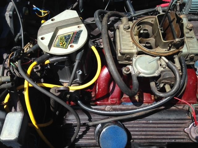

Here is the pic. Now I am wondering if it is even the original engine.

Old Aug 12, 2015 | 02:12 PM
Easy Mike's Avatar
Easy Mike
Joined: Jun 2000
Posts: 38,923
Likes: 1,482
From: Southbound
Cruise-In II Veteran
Originally Posted by haarvik
...Now I am wondering if it is even the original engine.
Can't say. Someone has been under your hood. The Accel is not stock, the valve cover breather and the Holley are not stock. The engine has been repainted. Check the pad at the front of the right head. You should find two numbers stamped there: one for engine identification and the second should be the VIN derivative of the car the engine was originally installed in.

verify your plug wires are on correctly. looks like you replaced some, not all. your vacuum lines look wonky. what jets and settings are in that Holley? put a vacuum gauge on the motor and do some tests, post what you find. whjat's with the Accell coil? there are known issues with those, especially as old as that one looks.

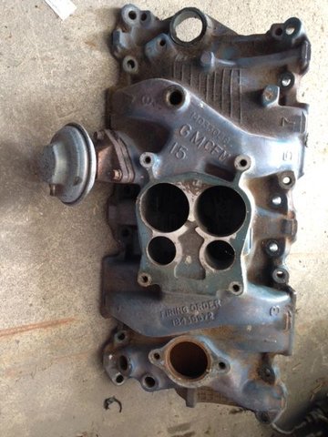

The intake is an Edlebrock with a Holley carb. I'm guessing they changed the distributor after changing those. I do have what I believe is the original intake and carb, pictured below. most of the emissions stuff is still there, except they cut off the exhaust lines and welded the holes closed. Wouldn't I need those if I went back to the original dizzy, intake and carb?
