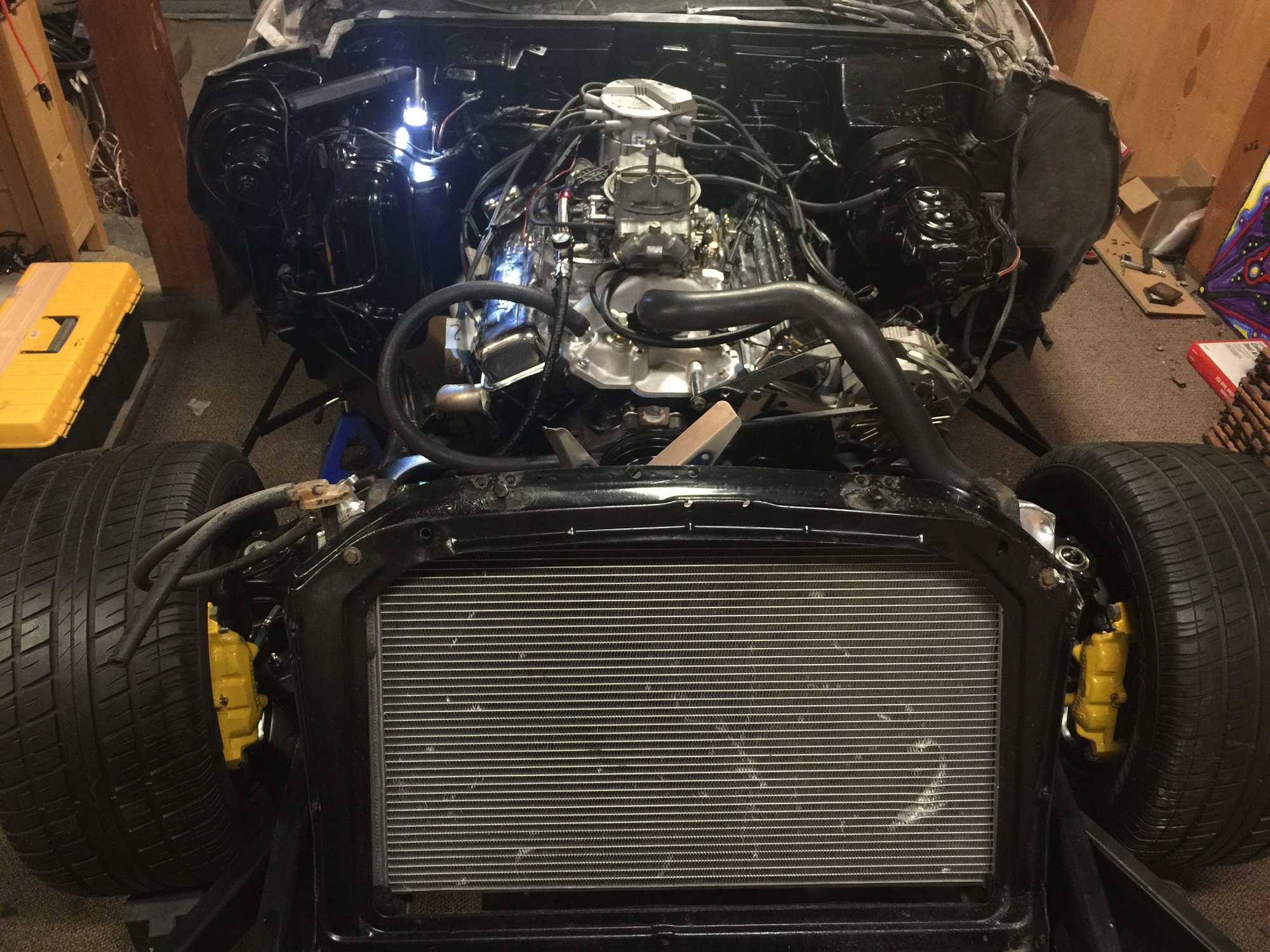

I just ran into an issue after replacing the intake manifold (Edelbrock #3701 with EGR). I re-installed the Holly dual port Carburator but my new purchase of an original Thermostatic Air Cleaner base does not fit with this dual port carb. I've read that the Quadrajet (which I don't have) may be the only one that fits with the original air cleaner base required for SMOG.
Q: Is there an Edelbrock carb or other brand that's 50 state legal that'll work with the original base?
I can of course put the Holly back on at some point unless I can get a legal carb with good performance.
Thanks
Here's my new build. Started up after partial rebuild and front end tear down.
1976 Front End/Engine Rebuild

Can't answer your question but it's looking good.

It looks like you've got headers on the car, too. How do you intend to hook up the "hot air tube", that attaches to the intake snorkel on the air cleaner?
Holley used to, and may still make, a Q-Jet (spread bore) replacement, that might do what you're looking for, assuming you don't have a working Q-Jet that you can use.
BTW, that's NOT a "dual pot" carburetor...it's a "Four Barrel".
