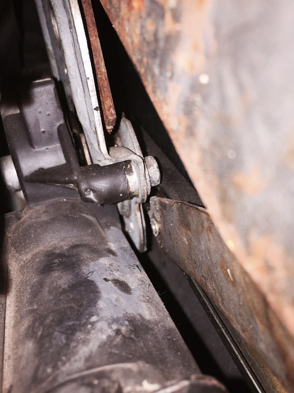

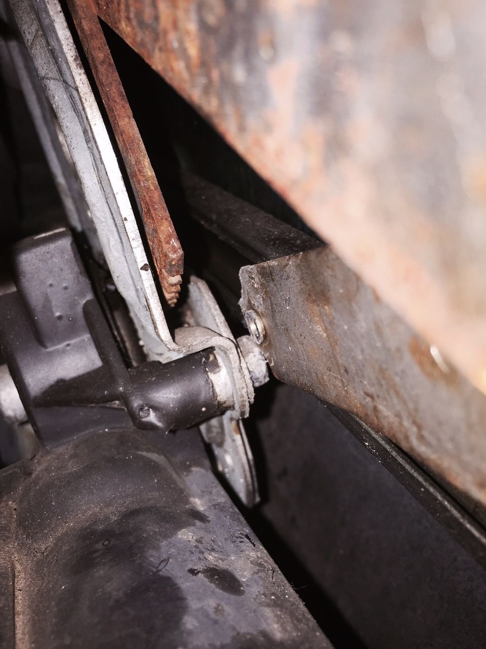

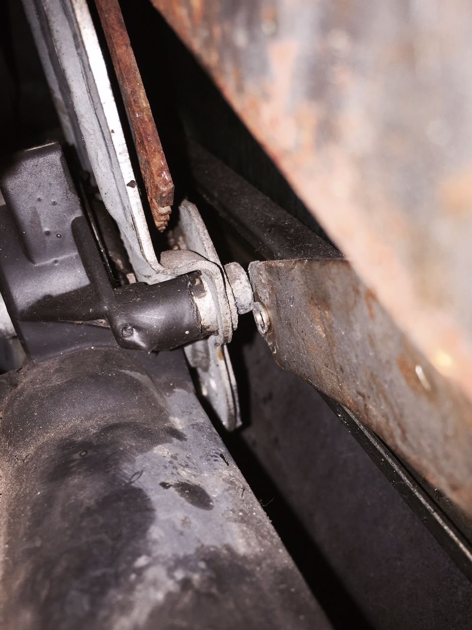

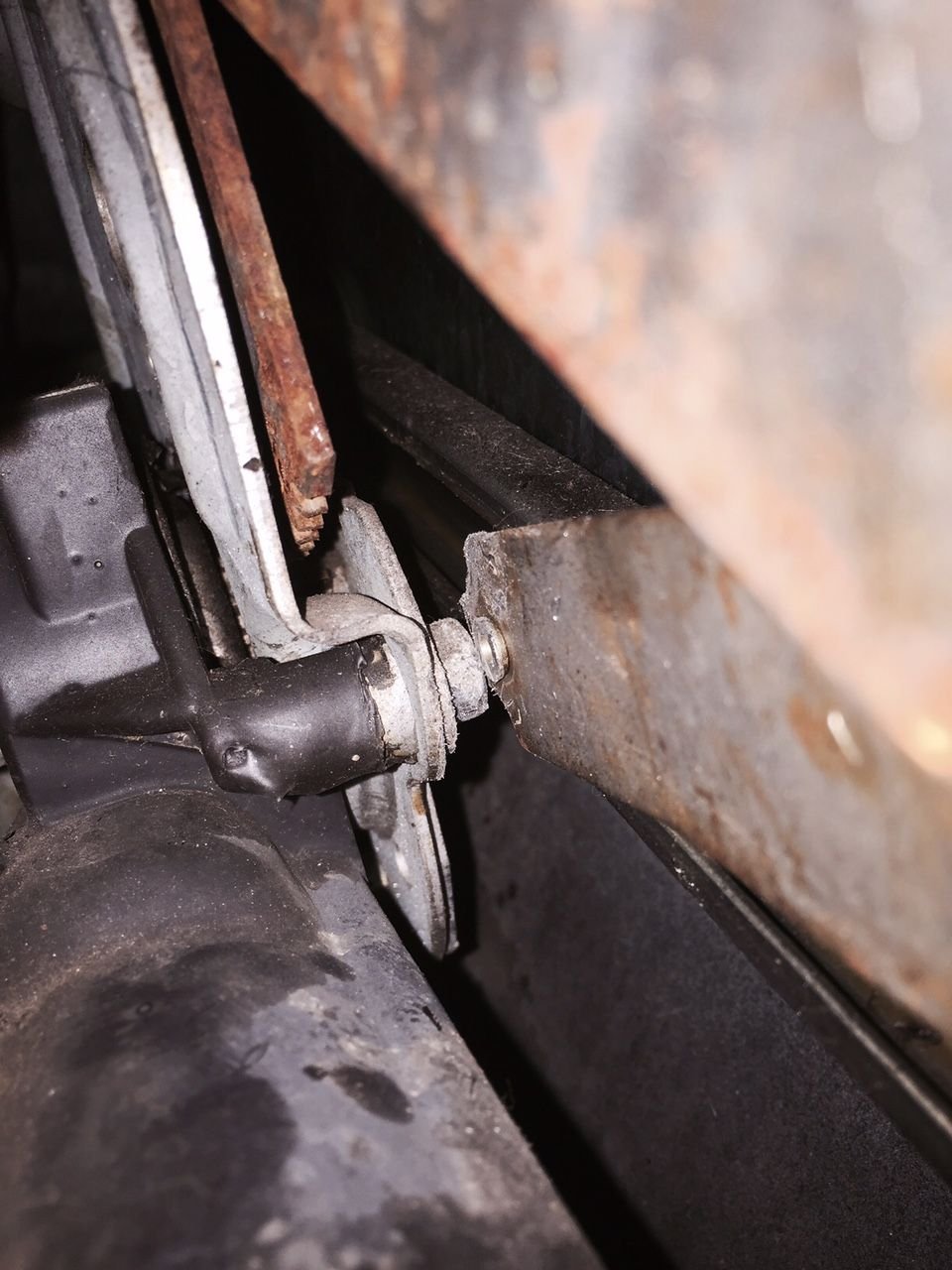

Actually go some reasonable pics...
I've got a couple that show what happens on the way down, then how it jams on the way up again....
On the way down, hasnt made contact yet
Down a little bit more, just starting to force its way past...
Down further, solid contact
gone passed now.
Then try to go up and this is it Jammed on the way up

also in your pics, the arm that is pointing up towards the camera looks like it has a bend in it about 4 inches up from the end causing the piece that hits the bolt to be pushed closer to that bolt.

Well spotted,
There were a few "bends" in all the wrong places....
All straightened out and working perfectly....well as perfect as a 37 year old window will work
