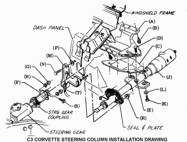

The Transmission/Steering Column Lock may be out of adjustment. The cable in the image below (T) connects to the lever that extends (toward the engine) from the base of the column. The cable is connected to the transmission linkage and will only allow the key to be removed when the lever is in the full up position. Find the lever and pull it up as far as it will go and then try to remove the key. If you can now remove the key, let us know. You'll then have to find out why the lever is not being put in the full up position.

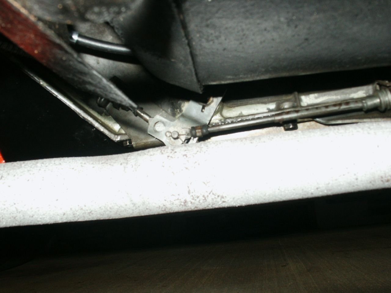

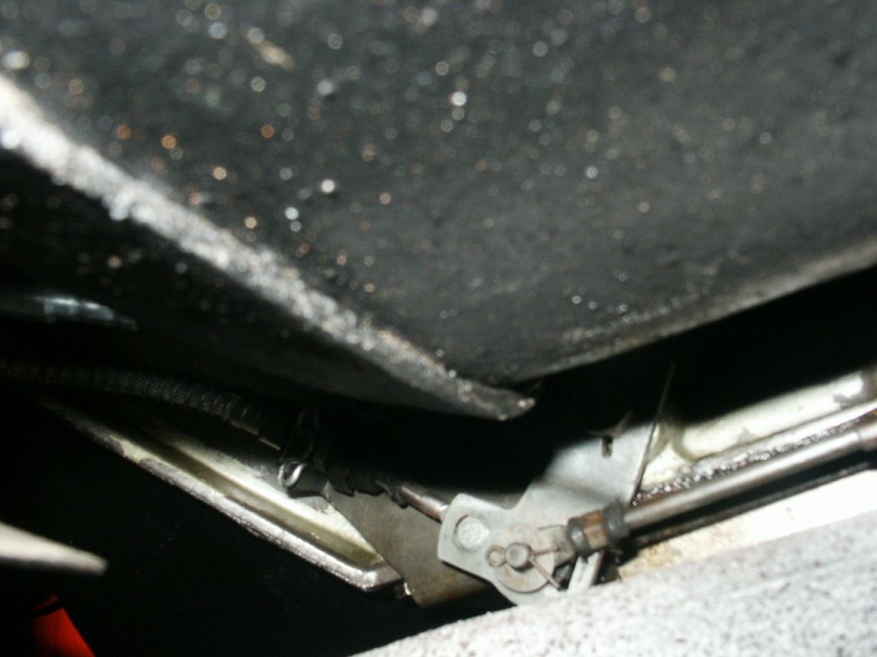

Check the linkage at the transmission. If the lockout cable is all
the way up and the transmission is in Park, it should look like this:
Donnie
