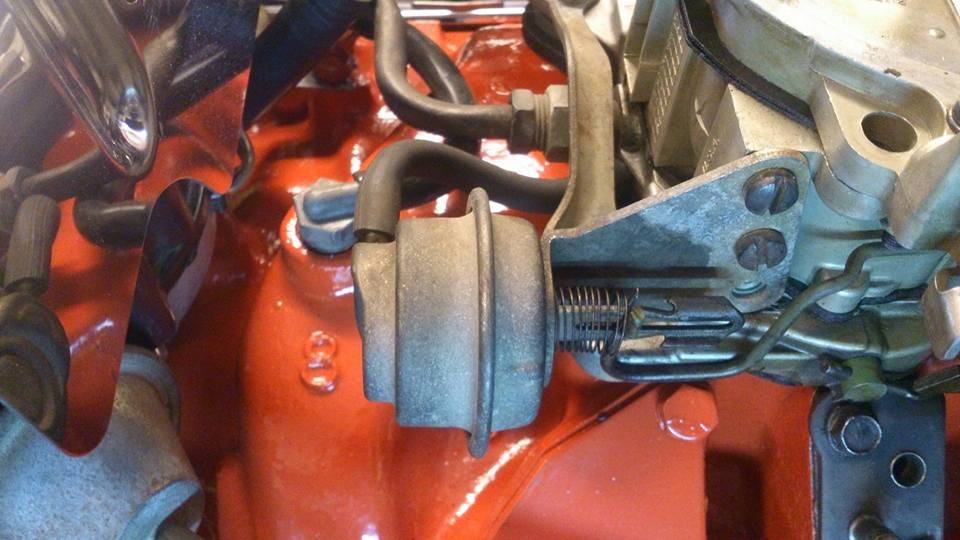

Hi all
My choke pull off has stopped pulling and I need to replace it. Can anyone please help me find the part number for this. It's for a stock 1975 L-48 with manual trans.
Thanks
Fredrik

Thanks! The problem I have is finding one that looks like mine with the hooky things (if you get what I mean). The most I find don't have the hook like shape where the rod attaches.

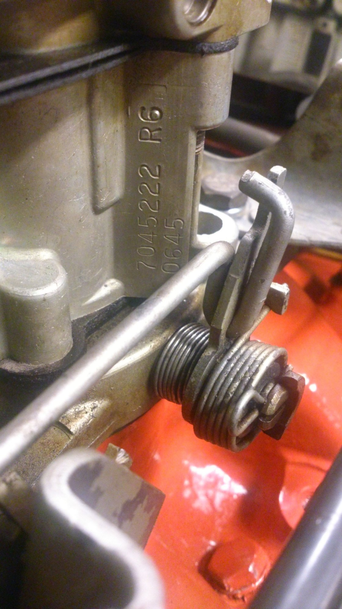

What is the number stamped on your Quadrajet carburetor?
Look at Quadrajet part number 3834D.

Ah of course! I seem to have #7045222.

Apparently your carburetor has 2 choke pull-offs. The one you pictured is the rear, or secondary pull-off. Do you also have a front choke pull-off?
I think I found one that matches the one in your photo. Look at Quadrajet part number 3871.
http://quadrajetparts.com/quadrajet-...gmc-p-579.html
Also, according to Lars Quadrajet paper, 7045222 is for an automatic.
70 = Rochester ID pre 1976
45= 1975
2= 49 state (non-California car)
2= Chevrolet division
2= automatic (odd number would be manual)
That looks spot on.
45= 1975
Thanks! Really good info. Yes I do also have a front one.
This raises the obvious question. What are the differences between carbs for man/auto? Kickdown something?
