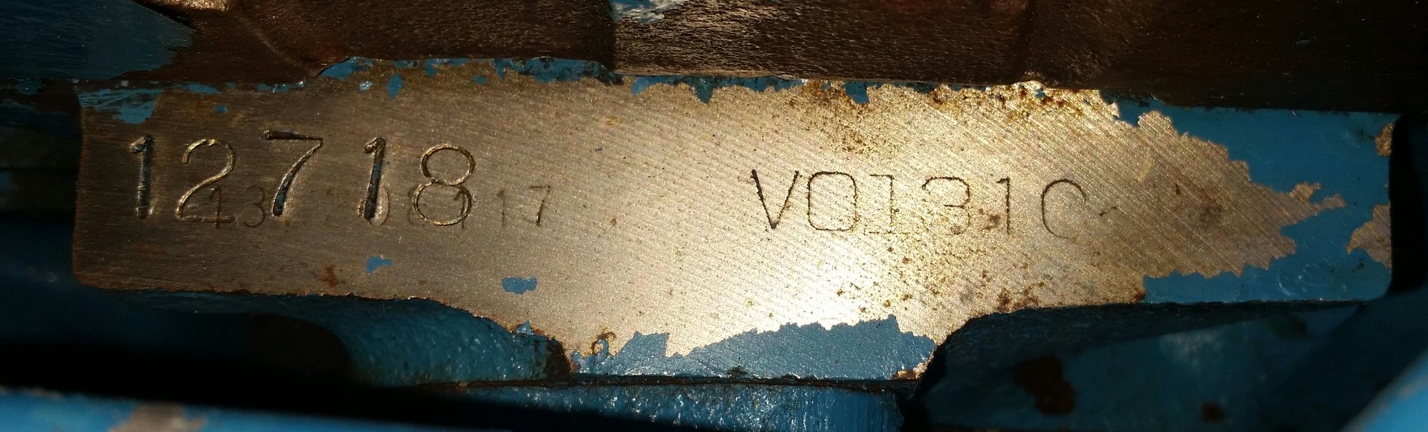

It's 15 years later now. I've gotten over the fact the original engine is lost forever but I can't figure out what exactly is under my hood. Some sort of early crate motor or rebuilt and the block stamps aren't exactly clear.
No real hurry to figure it out. Just been curious over the last few years but any help would be appreciated. Thanks

3970010 is the casting number for the 350 block.
A223 is the casting date, Jan.22, 1973 or 83 (Most likely 83 based on the blue color, but it may have been repainted. A 1973 block would have been orange.)
13?208117 (I'm guessing on the lightly stamped spaces) is the partial VIN of the vehicle it was originally installed in.
12718 is "unknown". Could have been stamped by anyone for any reason. Certainly not factory.
V0131C?? is the engine build date and broadcast code. It's a Flint built engine, dated Jan. 31, 1973 or 83. The C?? (missing two letters) would indicate what the original HP was, manual or auto, etc..
If you could get a picture from a different angle that may show the letters after the "C", it would help ID the engine.
I believe at a certain point in Chevy block development the engine stamp pad changed from a rectangle to a square. This may also help nail down a certain time period.

so now you know what you already knew. 2-piece seal 350. could be 2-bolt or 4-bolt mains. 010 came both ways. the 12718 overstamp looks like an engine rebuilder's number. pull valve cover and get head casting number. but it'll be a 462624 or an 883 casting, depending on decade it was made. still won't tell you flat or dished pistons, forged (unlikely in a rebuild) or cast. won't tell you valve size, but it is most likely 1.94 and 1.50. and won't tell you cam profile. but you can be fairly sure it is 170 to 370 hp...

I'll try to get a better pic of the "C" code but even looking at it in person I can't really see the missing letters.
Originally it's a L48 car. I'm guessing it's somewhere between 230 and 250 hp now so other than originality I'm not really missing the original block. Sure wish it had 370 hp though.
