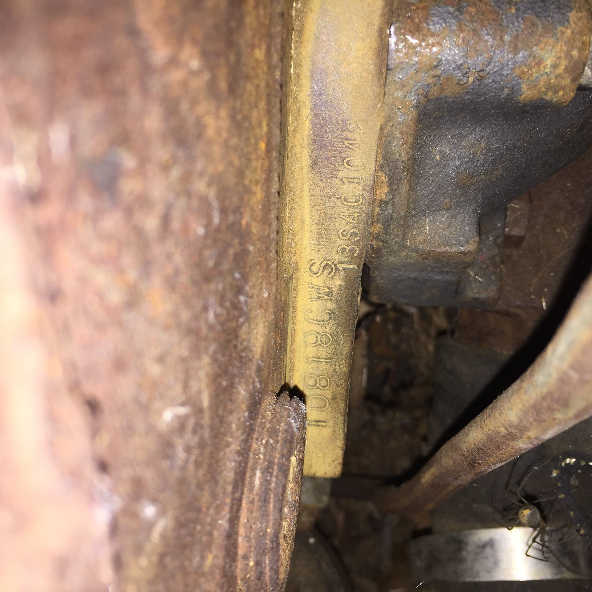

maybe a squirt of clear? 1048. nice early car...

Engine pad indicates Tonawanda August 18th....1972 ? There's no hint of California emission control left on the car. Not a fan of it, even though it may detract from the value. I plan to raise the compression, better intake and ignition.......maybe research a better cam for it. All in good time though........I really got to see how the frame is. Nice photo bomb by the spider.......

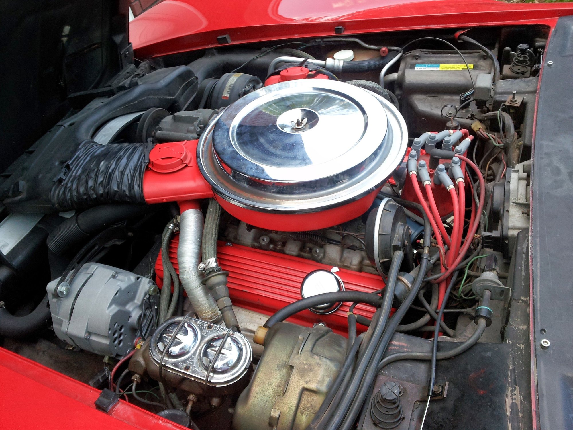

I took the 350 in my '80 and doctored it up a bit. That motor was a wheezing, coughing bundle of mess when I got it.
When I researched it I was surprised to find the short block was actually not a bad build from the factory. Decent compression and a nice .450/.460 lift cam. I gave it a better set of lungs so to speak, runs really good now. Not a world beater, but will light'em up if desired, and turns up to around 6k, with that excellent small block growl we all love......
