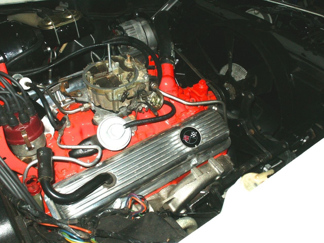

EGR is connected on my 73 and I haven't had any problems with
the engine running on mine. Haven't checked the RPM in PARK, but
it idles at @800 in drive with foot on brake when warm.
Also TH400 transmission. Photo below of EGR connected.
Donnie

Thanks for the photo!
