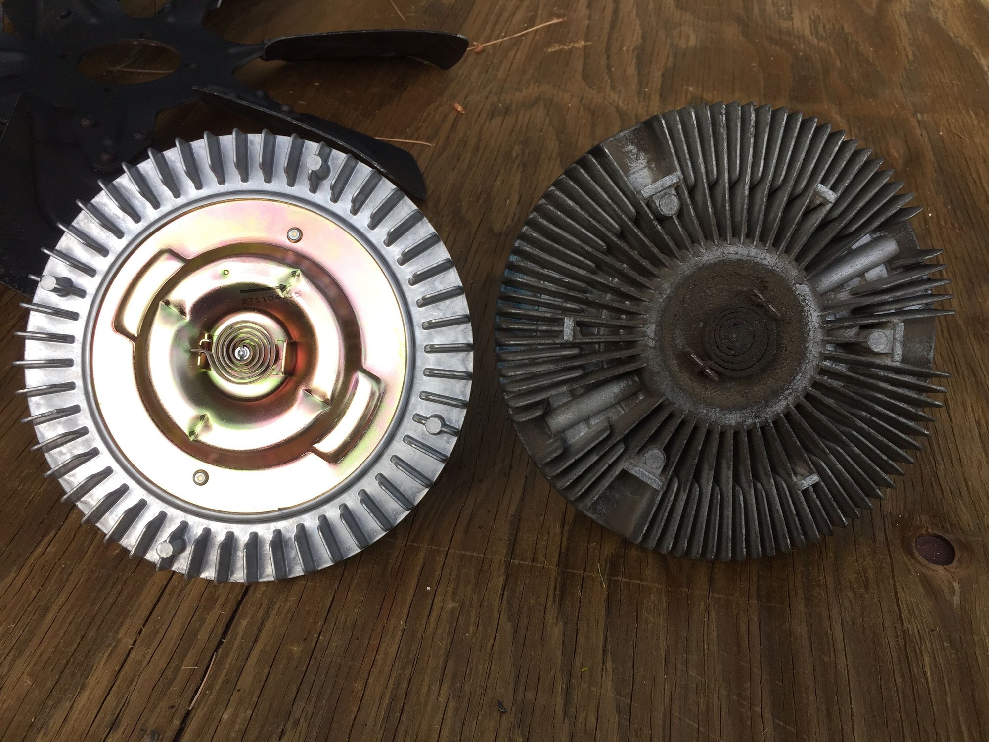

Here's an original 79 L82 clutch.
Old Sep 12, 2015 | 09:18 PM
Dodosmike's Avatar
Dodosmike
Joined: Apr 2008
Posts: 9,435
Likes: 239
From: Powassan ON
1978. Non AC on the left. Original with AC on the right.
Don't think I have a front shot of the new "with AC" clutch I ended up with.
Dodosmike

Thanks guys for the pictures. I see what's missing. I don't know where that piece went but it probably requires a new clutch.
Old Sep 13, 2015 | 08:13 AM
Dodosmike's Avatar
Dodosmike
Joined: Apr 2008
Posts: 9,435
Likes: 239
From: Powassan ON
A non AC car needs a non AC clutch
An AC car needs an AC clutch
I tried a non AC fan (locks up at a lower temp) on a AC (but no operational) car, no good. The clutch would bolt up to the water pump mount.
The mounting "ring" to the water pump is different. The 5blade fan mount is smaller that that of the 7 blade fan.
Spend the money on a good clutch. Cheapies are "cheap" for a reason?
