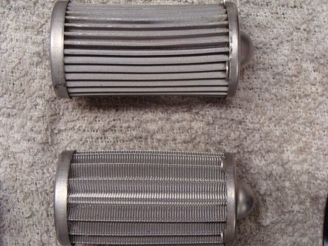

I think I mixed up my Holley fuel filters on my last cleaning. I was having a high rpm fuel starvation problem. Look at the pictures and tell me which would be the 40 micron filter (finer mesh?) and which would be the 100 micron filter (coarser mesh ?).

looking at the Holley web site the second image above is the 100 micron, lines going across filter material

That is what I thought. Thank you. I didn't find them on the Holley site when I looked.
That rules out the filters. They were in the correct positions.
