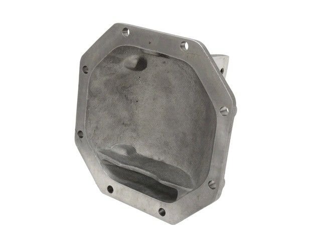

Ron, I also agree with the folks here, if you do not have a broken ear, or stripped threads there really isn't any reason to change out the rear cover for the heavy duty one. However...
picture courtesy of Corvette Central
the inside of the cover has is a web on one side that does provide strength to the cover. I've seen the web on more than a few rear covers with large pieces missing and or large gouges in it. This is the result of the ring gear bolts backing out and striking the web. Not an uncommon problem to have encountered in these rears.
At some point they were being assembled without lock washers (presumably locktite was being used) and the bolts came loose. If yours is broken or gouged, by all means check the security of the ring gear bolts. I've opened them up in the past and found significant gouging, but no debris, with brand new looking lock washers installed.
Good luck... GUSTO
