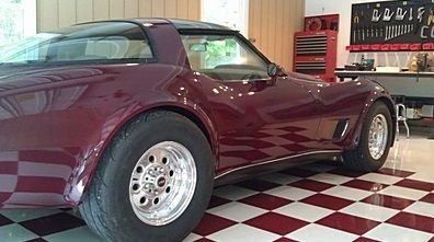

Got rears mounted and balanced. With new custom billet center caps made at local machine shop. I think they look great, chubby and stick out just the right amount. Now to find fronts that will work.

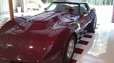

I like that look too. Old school all the way. Mine are Weld Drag lites, but they'll give you an idea of what the look I think you're going for will look like.

What size tire and wheel is up front? did you end up with a wheel spacer up front to clear the calipers. I like the look of your car and the rake.

What kind of spring pressures do you use to keep the tires from contacting the fender lips?
