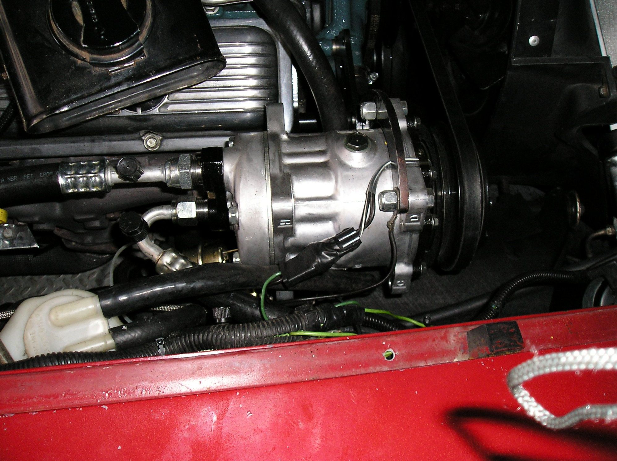

i just installed a 90* exit on mine. the tubes hit the under hood insulation just barely. assuming good motor mounts it should have clearance.
I'll try to get a photo...

its not a problem on my setup but if you have the air pump (which I dont) I can see where it might have some fitment issues.
I have my guys looking at the issue and am being told if it clocks 90* then the discharge hose would be the high hose and the suction hose would likely be rubbing the coolant resevoir (again mine is a 75)
so the answer is a "definite maybe". I know thats not a lot of help but it is probably going to be a try it and see.
The suggestion is to use a short drop fitting. you might find it under the number SB1323SD.
If y6ou google that number you will see images of how short it is. Any decent AC shop should be able to make a hose with that fitting and a charge port somewhere on the hose.
we do it all the time.

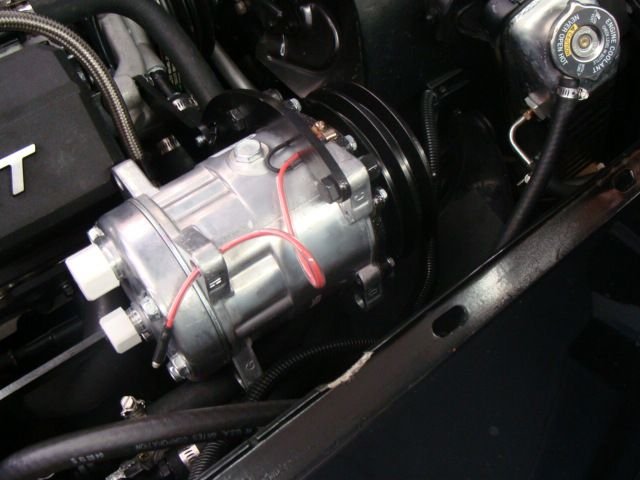

This is the style compressor that came in my Classic Auto Air kit for my '81. I had to trim the one ear off to clear my tall valve cover and to give me more belt adjustment.
