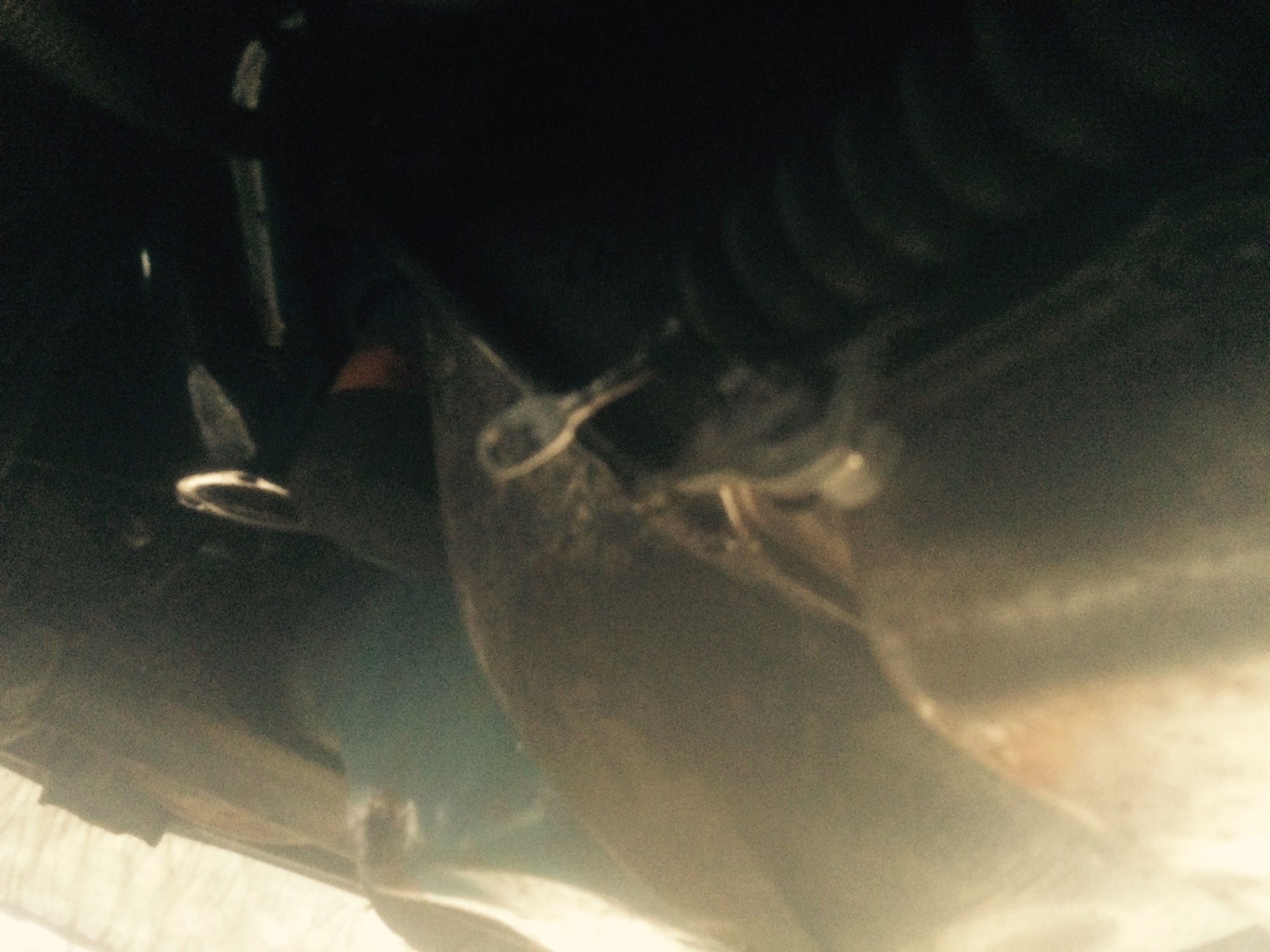

my bracket is similar to the one in Mooser's pic. I have the bracket on the center 2 bolt holes on the pan. I saw it mounted that way in another pic. should it be on the first 2?
Old Oct 12, 2015 | 04:43 PM
nspctr1's Avatar
nspctr1
Joined: Jun 2006
Posts: 44
lets see if this works
Old Oct 12, 2015 | 04:44 PM
nspctr1's Avatar
nspctr1
Joined: Jun 2006
Posts: 44
sorry for crappy iPhone pic
Old Oct 12, 2015 | 07:43 PM
Mooser's Avatar
Mooser
Joined: Apr 2011
Posts: 11,183
Likes: 3,334
Can't tell much from that pic.
The bolt that the cable attaches to should point more or less at the first bolt in the trans pan when in park. The cable bracket is in the next two bolts (if I remember correctly) with the cable hook part at the back.
See if you can get a better pic tomorrow
M
