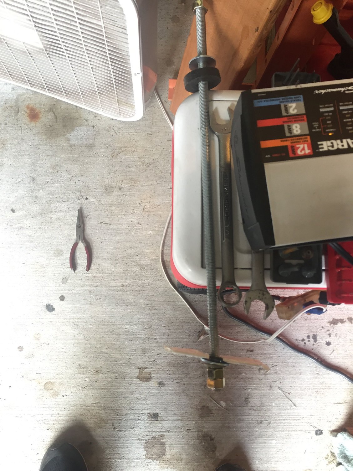

I used 5/8 all thread to get mine in.
As for removing the ball joints I like the oem 25297 or 25262. One is listed as a tie rod tool the other a pitman arm tool. They both work great for removing stubborn ball joints.
