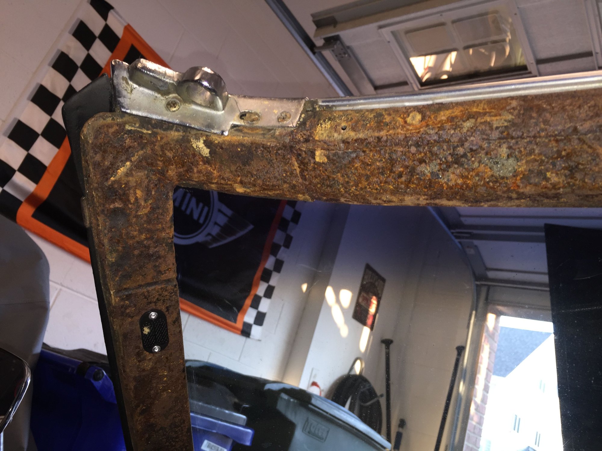

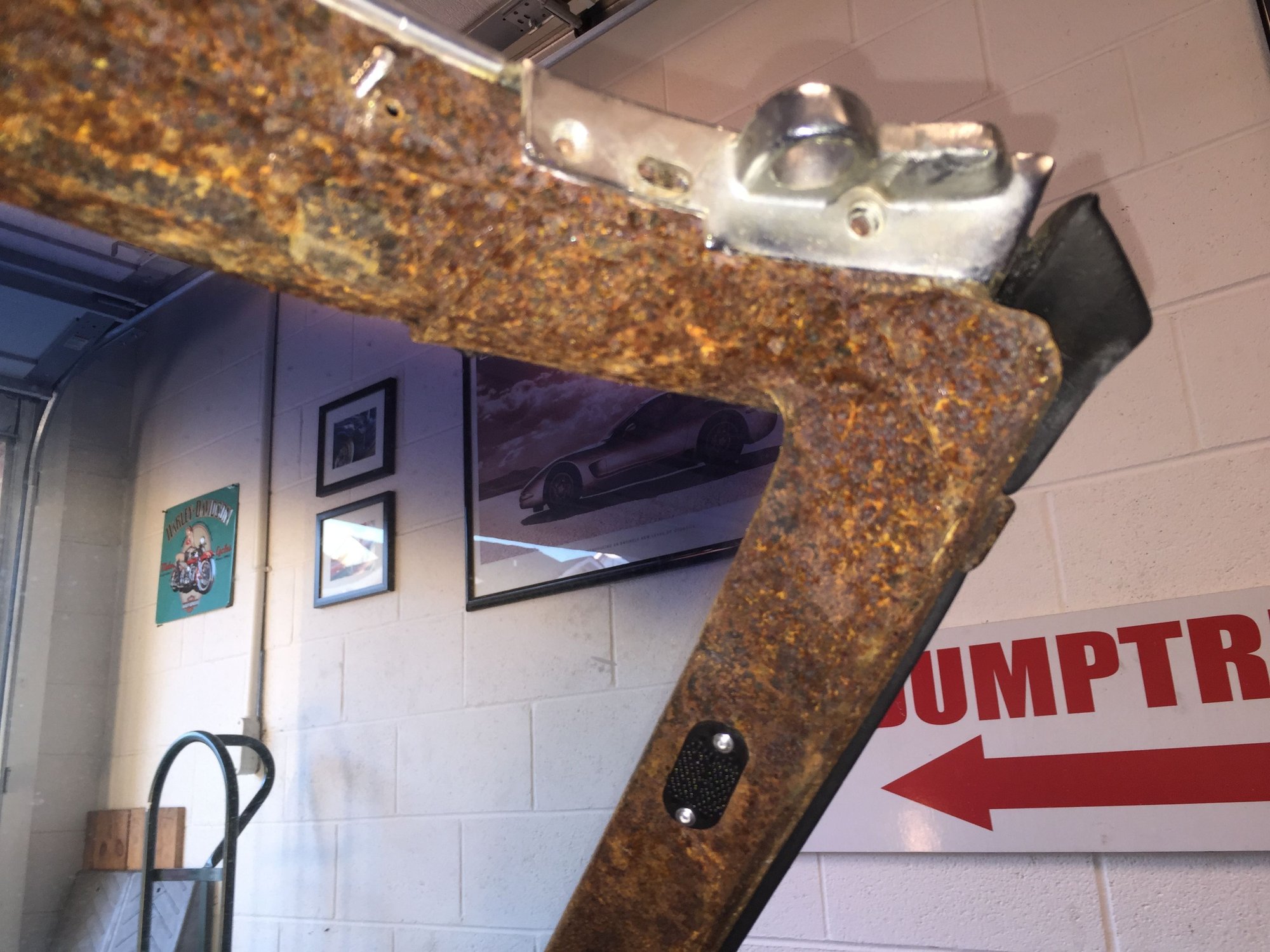

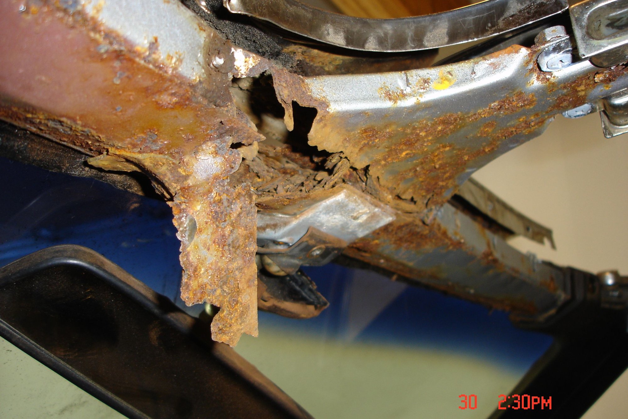

so heres where Im at.....
the flash actually makes it look a little worse than it really is....although its definitely not good. I need to get the chrome off to make a final assessment on the top....but from what I can see, Id say the top has significant surface rust, but no rot that I can see.....its right on the edge of the POR15 and seal it up vs. having it cut out and replaced. The interesting part is that it actually gets significantly better on the way down towards the windshield and the cowl.....theres zero surface rust by the time you get down to the vin tag. That being said, the #1 body mounts look similar but not quite as corroded as the upper header, with what Id categorize as "significant surface rust". I still need to get her in the air this weekend to take a good look at the #2 and #3 body mounts. #4 is good, and the rear kick ups are spotless.
Its all a little overwhelming for a car that looks so good in every other area.....but I guess thats the classic C3 story.....heres to winter projects

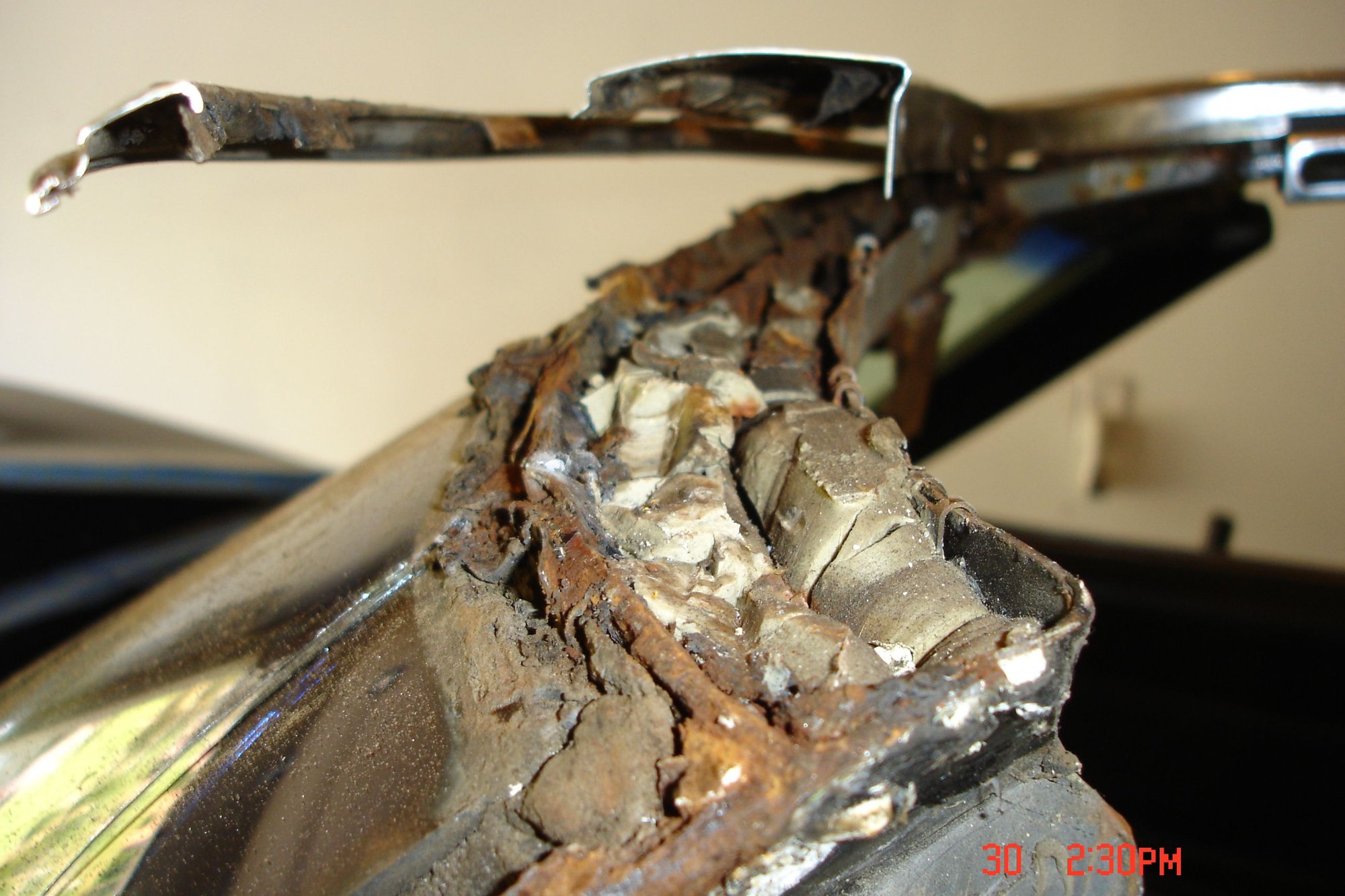

That's not looking too good.

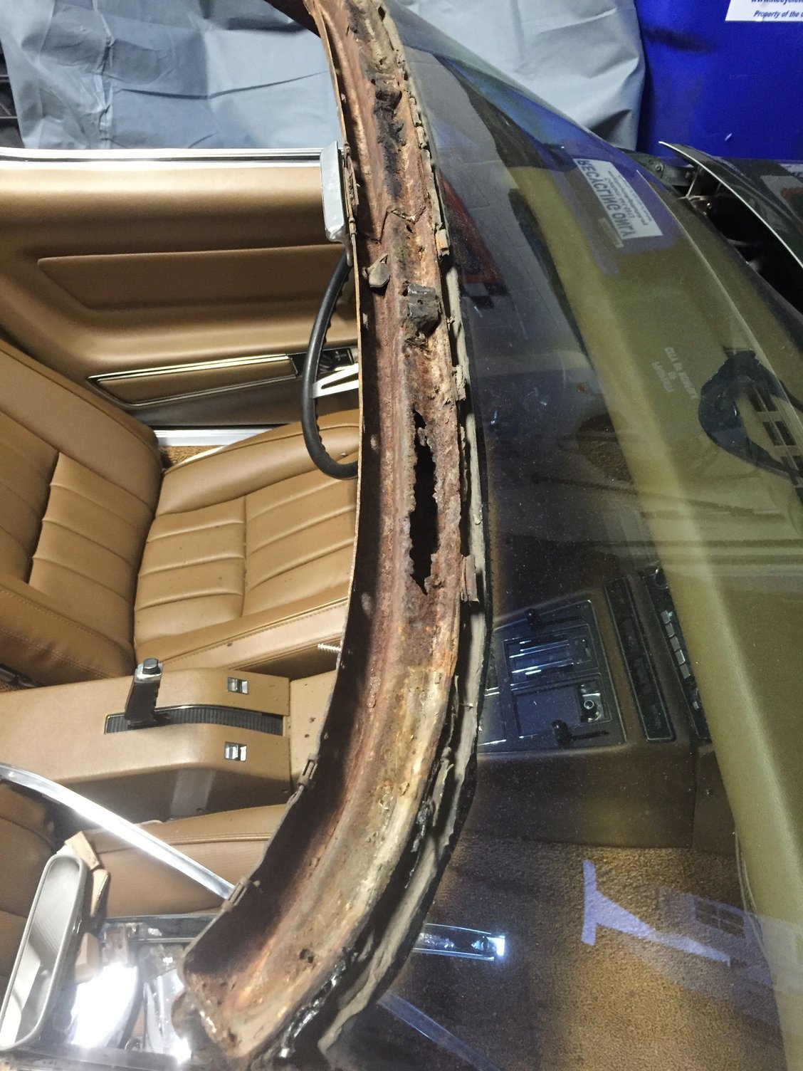

But, as someone else has already said, there is that screw along the top of the windshield behind the trim to remove the corners. If you look at RVZIO's third picture, I can almost guarantee the crack is from removing said screw.
When I went to disassemble my donor body with the seller, he wanted the upper corner trim. Car had a brand new windshield just put in it with the sticker still on the glass. Was trying to get the angle onto that screw with the screwdriver and CRACK!

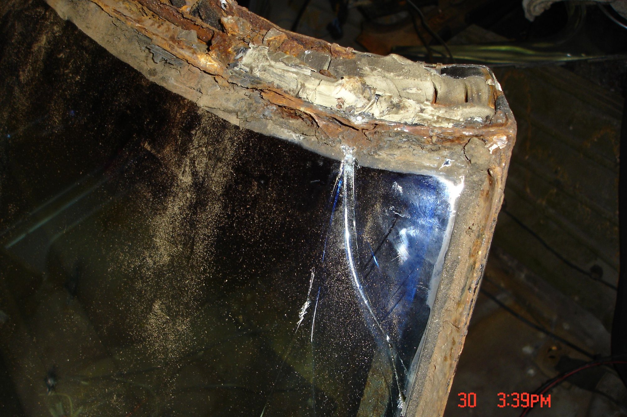

Yup Ibanez540r that's what happened to me trying to take the corners off. You hit the nail on the head.

Default trim
Just in case you may have thought my car started out as a dumper.
You just really don't know what lurks underneath everything.
R
Well you get the idea.

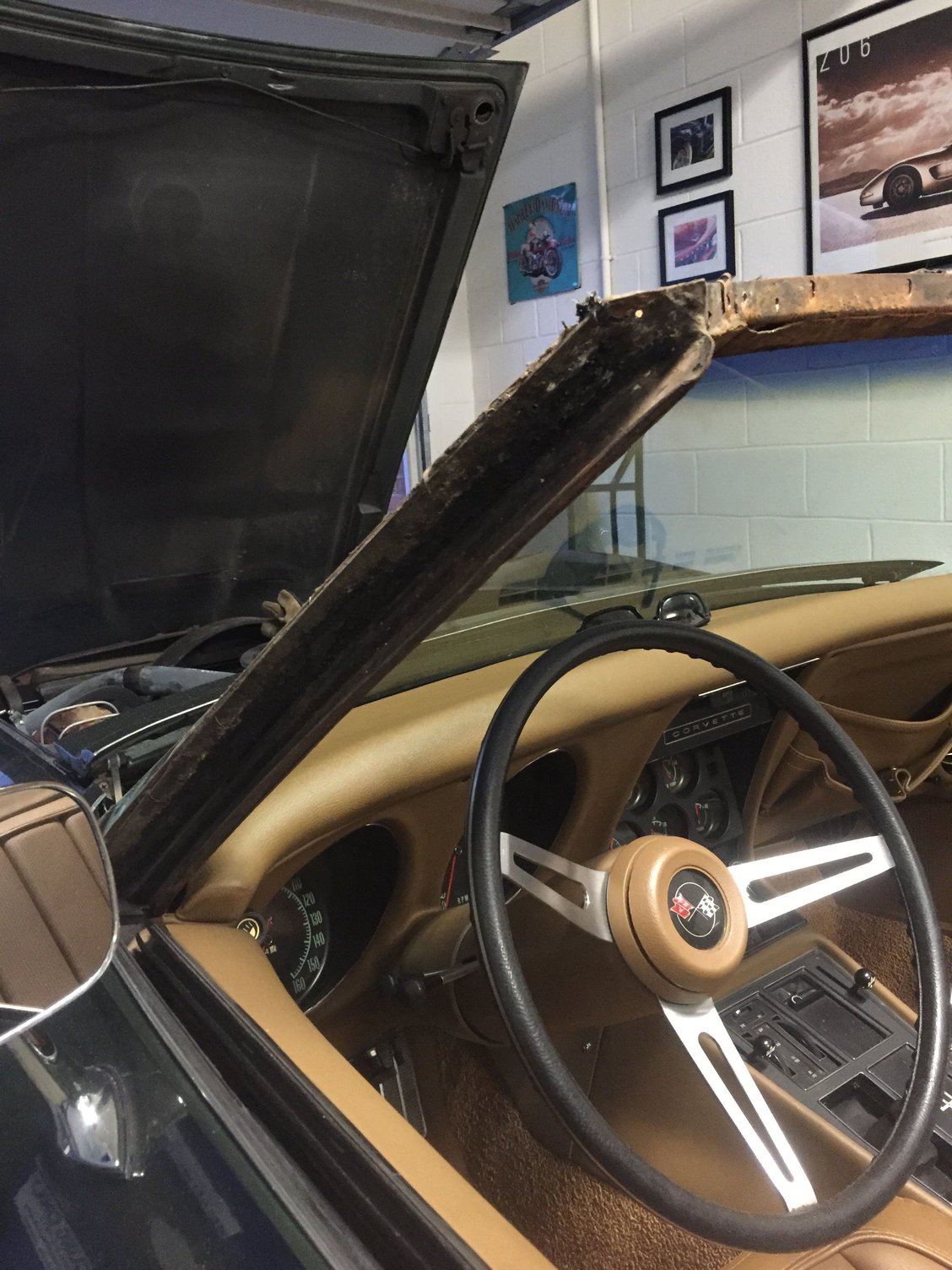

And they said it couldn't be done!!!....all the trim off, windshield still in one piece! On the down side, theres definitely going to need to be some cutting done. I talked with Zipp Corvette today and they said that its manageable, and their body shop is very experienced in this repair. As you can see in the pics, the sides are actually in decent shape, its the corners and the header that will need to be cut out and replaced. Heres hoping for minimal carnage down low
