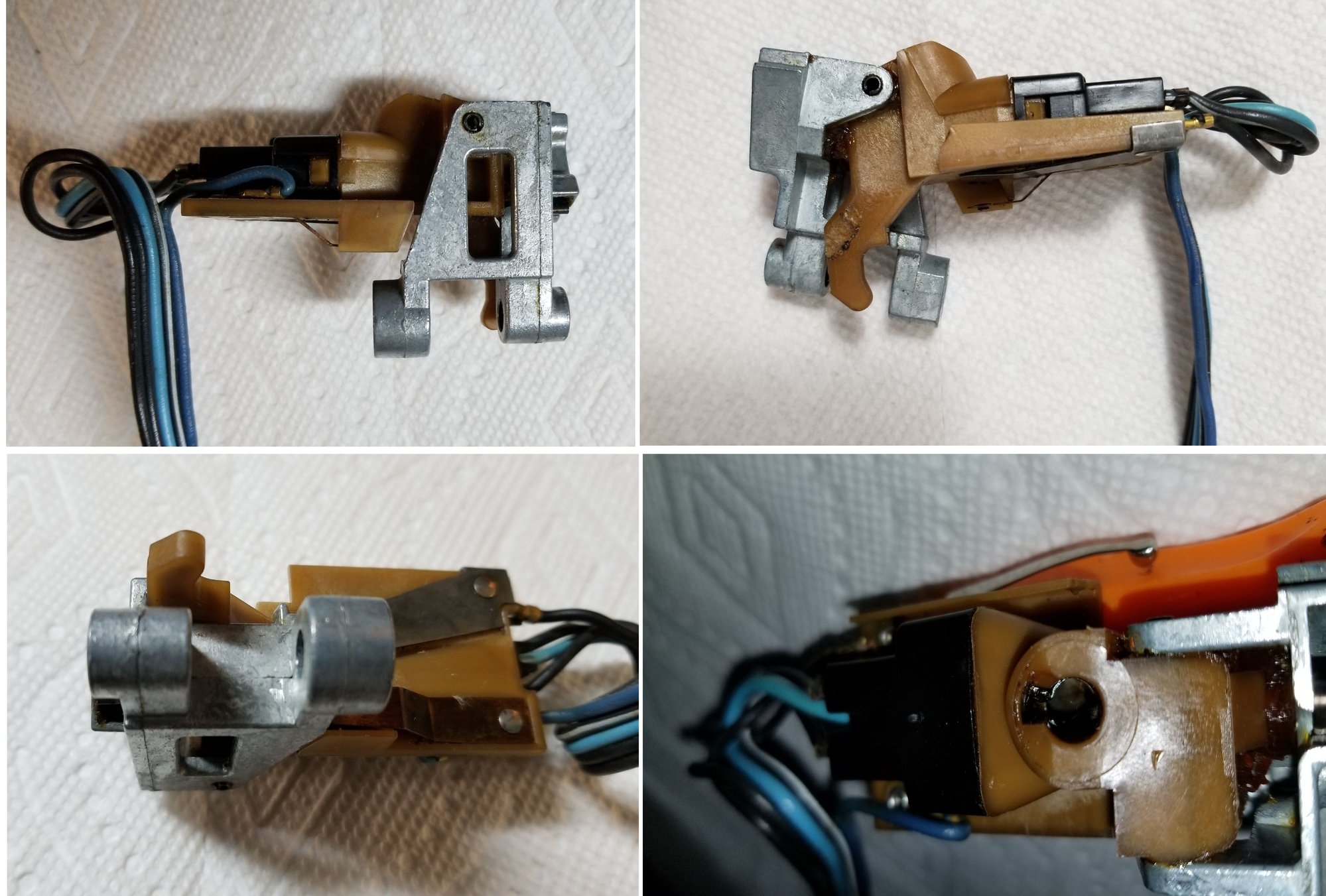

First a couple questions, do you have a tilt telescoping steering column?
And what seems to be broken on your switch?
The switch portion of the switch is real simple in design, it's a 3 position rocker switch with simple brass contacts...
If it is a broken pivot bracket on a T&T column I can get you some GM part numbers.
Many different GM models used the same pivot bracket that with a simple modification can be switched out and used on your 77.
The GM #78273386 switch used above is also very hard to find nowadays...
The original 77 Wiper/Washer switch for a T&T column was GM #7827152
The 386 switch as stated above does need 2 simple modifications...
Physically, the 386 & 152 switches look the same at first glance...
Here are a few angles of a 7827152 switch...
The pivot bracket on the switch in my photo is of first design, later GM made the pivot bracket stronger by eliminating several cutouts when the bracket was cast...
Newer style pivot bracket(s)
