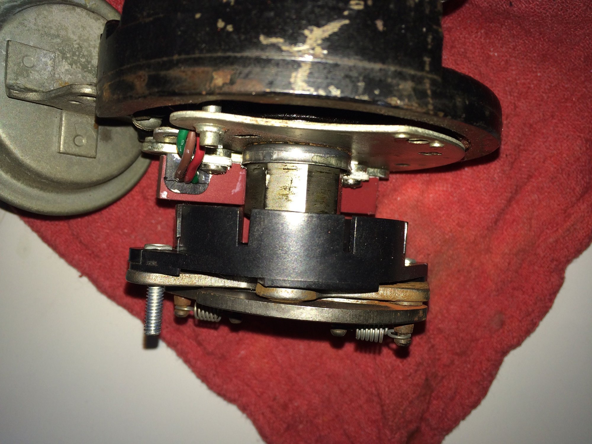

Can you post a picture so we can see what was actually done to the distributor?

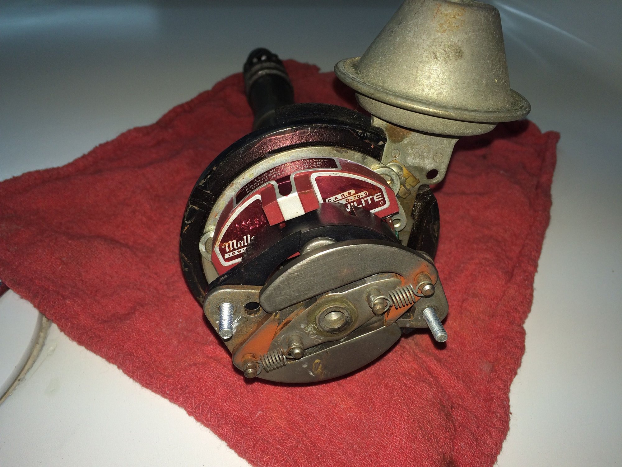

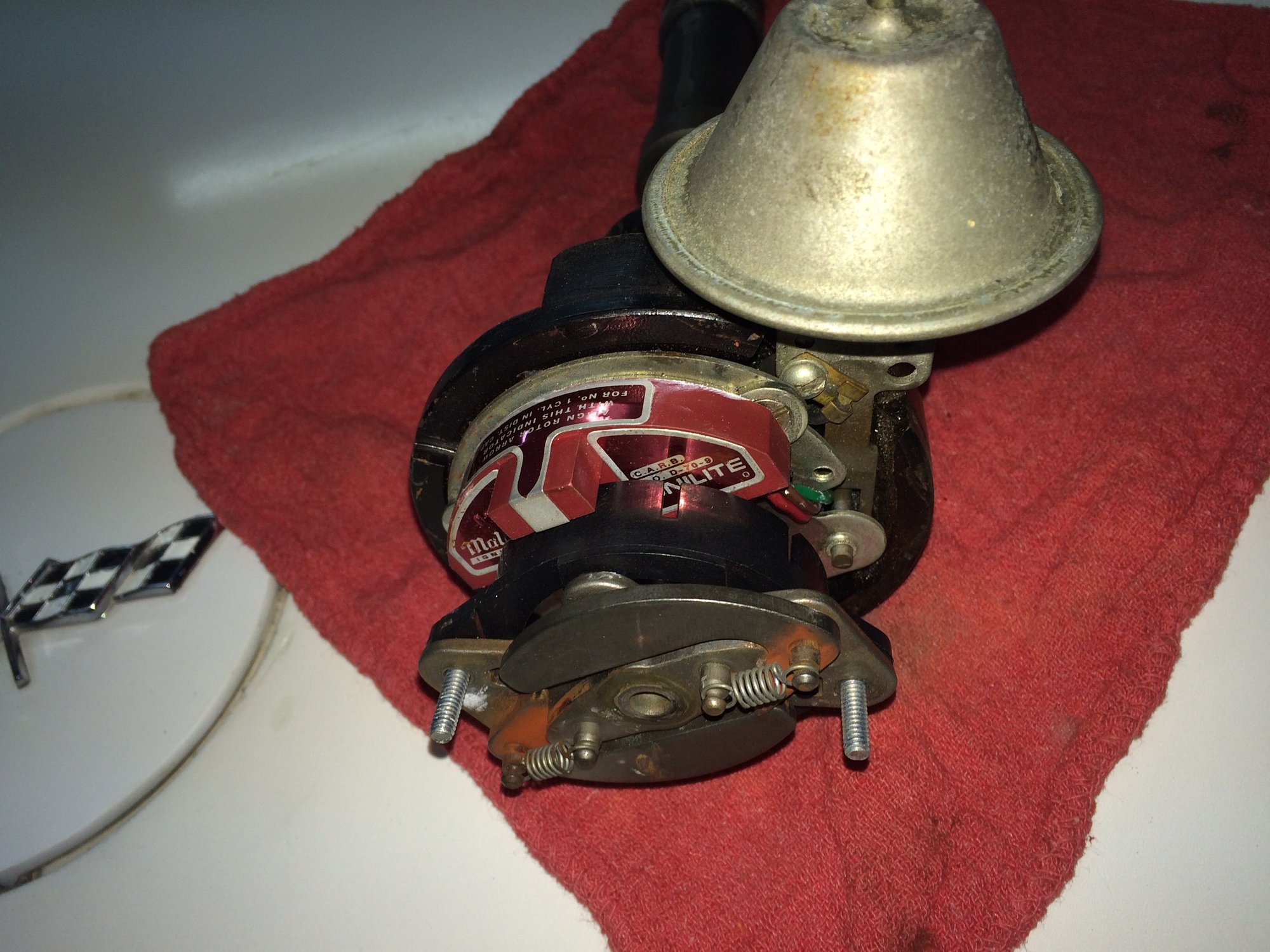

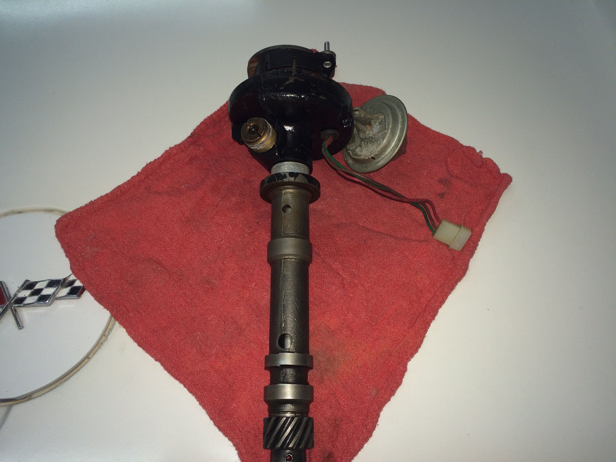

Here's some pics of the distributor. I bought it from another forum member. It came with a cap, wires, the matching coil and bracket. $ 250 included shipping.

Mallory Uni-light is good stuff, take it somewhere (speed shop) and get it curved on a distributor machine.

Nothing wrong with a std distributor at least for std engines, I would also suggest stripping the unit and check for wear and lubricate the unit while it is in pieces. Check the tach drive carefully for wear and make sure it is properly lubricated as well. You will need a timing light to check the advance (preferably a dial back type) or a timing tape fitted to the harmonic balancer on the front of the crankshaft.
