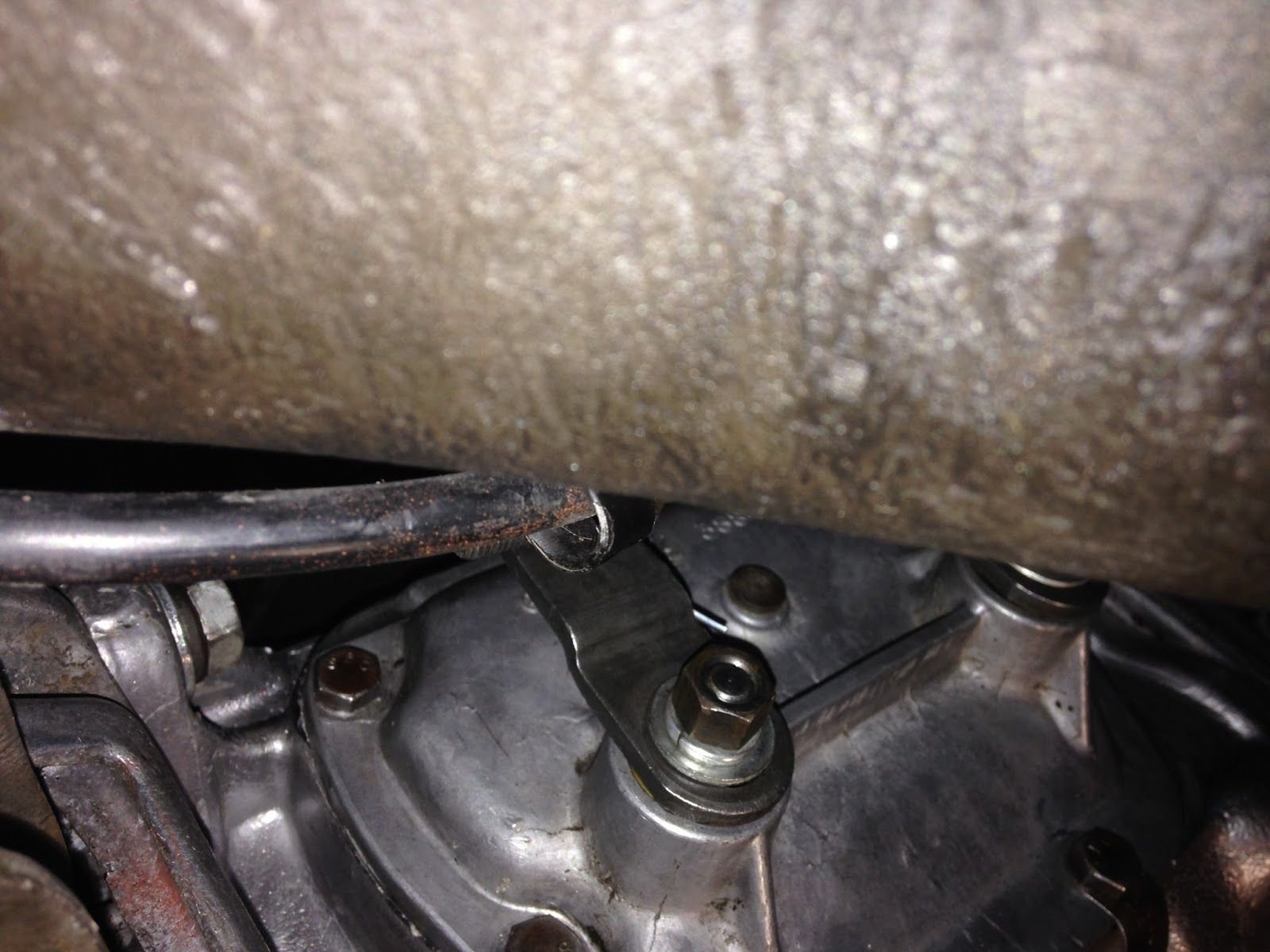

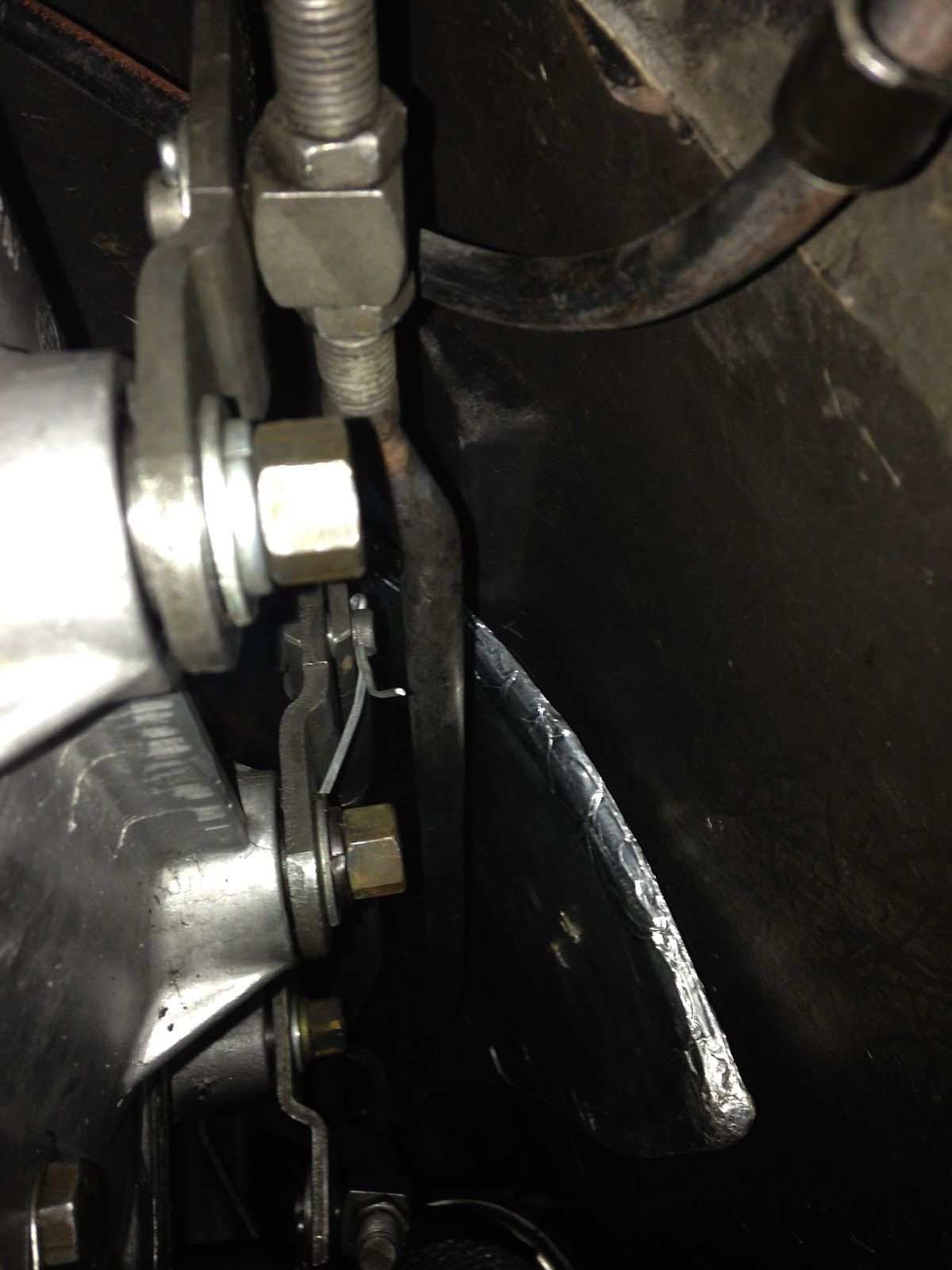

I finally got my 72 up on jackstands to try to diagnose my downshift issue....I was having to double clutch to get it into 2nd or 1st. Last time I took her for a spin and was trying to pull into the driveway it would go into 1st or 2nd and I had to put it in 3rd to get up the driveway.
Well so far I have found wrong clips, shifter levers turner backwards and a reverse lever that doesn't look like the sketch in the AIM at all.
Can anyone take a look at the pics below and confirm what I'm seeing....?
I have no idea if any of this is even part of my downshift problem but it can't be helping.
Brian

Sorry, those pictures are too close up for me to tell much.

There should be G clips holding the adjuster blocks into the shift levers and not cotter pins. Look at the slop in the last pic. G clips are spring loaded to put pressure on the shift lever and hold the rod tight against it.

Hard to tell but it looks right. Reverse paw on mine is much longer though.

According to those pics above my 1st-2nd and 3rd-4th levers are definitely turned the wrong way....The offset should be closer to the trans. It also look like they are in the short throw holes.
It's hard to get pics from further away with the trans in the car.
Brian
