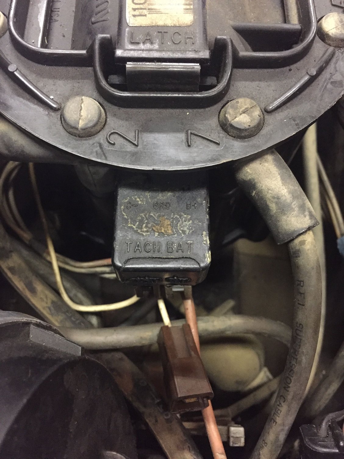

Recently purchased an 81 corvette that was in good condition before being submerged in water during a recent flood. I was given a price I couldn't refuse. We now have it running a running quite well.
We are working on the tachometer. We have located the wire underneath the distributor cap but can not find anything to plug it in to. Any help would be appreciated

The tachometer wire plugs into the underside of the distributor cap where its marked "TACH".

Toobroke is right.. here is a picture

It seems as though the wire is plugged in to Tach like it should be. What is the "extra" white wire?

I'm not positive but I think it's a factory test terminal.

Indeed.. the extra plug is for testing.
