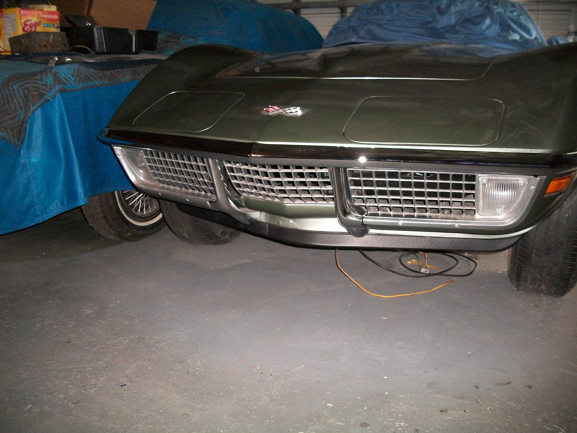

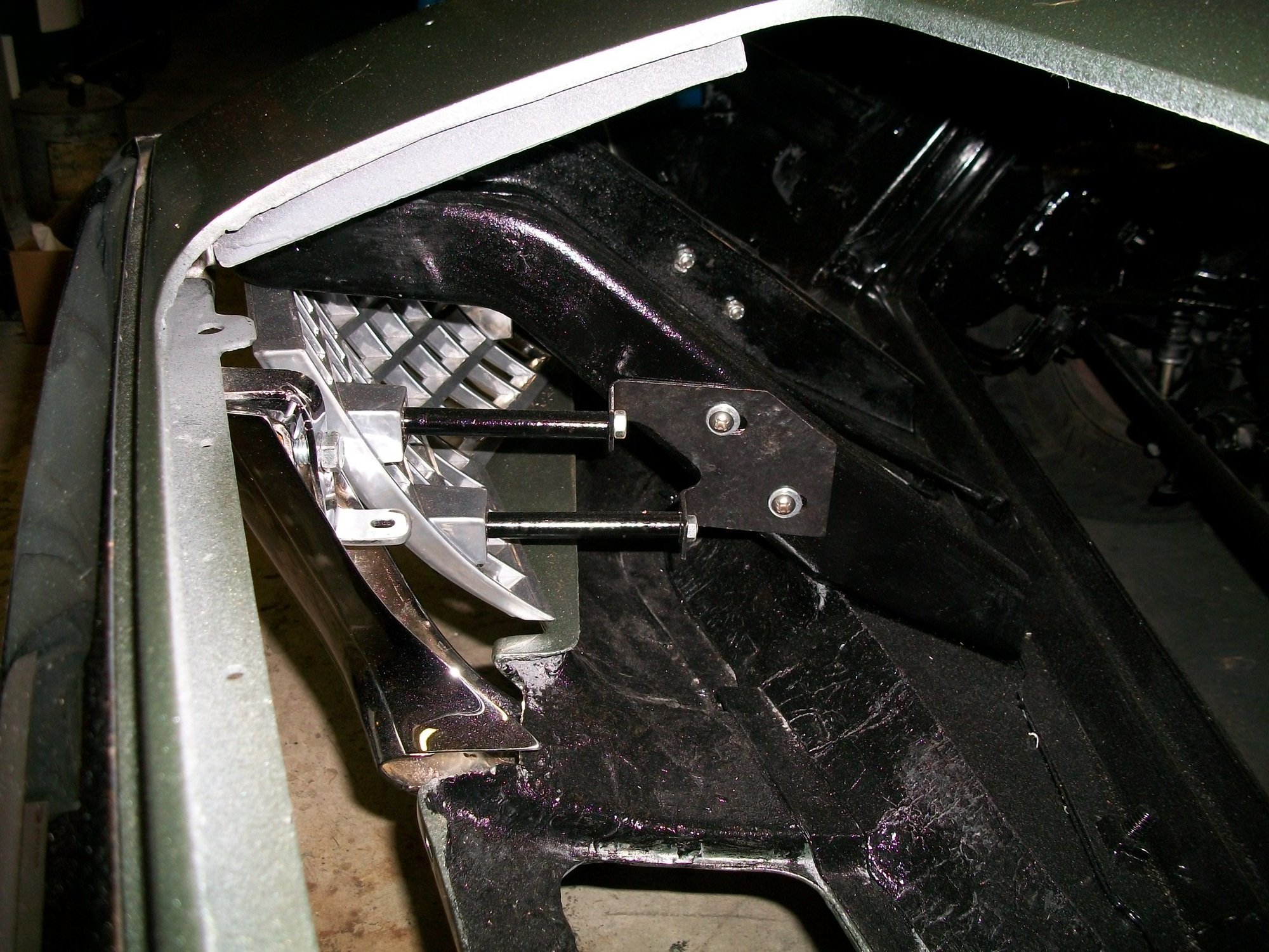

I moved mine out 4 inches to make it even with the front valence.... using stock brackets & longer bolts with steel tube spacers...

What a great idea, how much space is about your grills and the body
Look at the bottom corner of the grill in the first picture.... it`s like that all the way around. It`s about a half to 3/4 of an inch. Just enough so it doesn`t rub the paint.
We don`t have front license plates in Florida, and the grill looked funny sitting way back in there... without the plate brackets to hide it.
