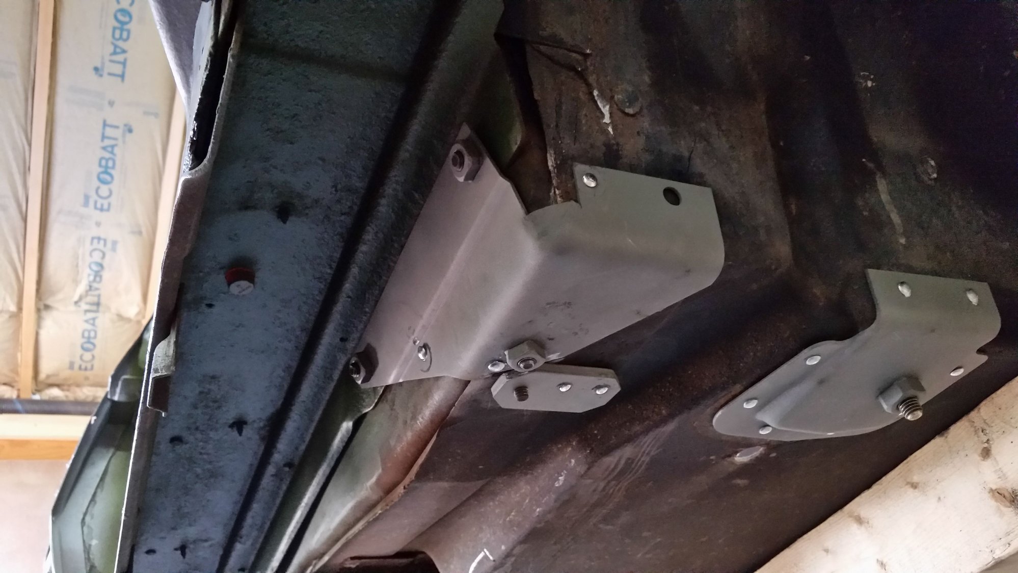

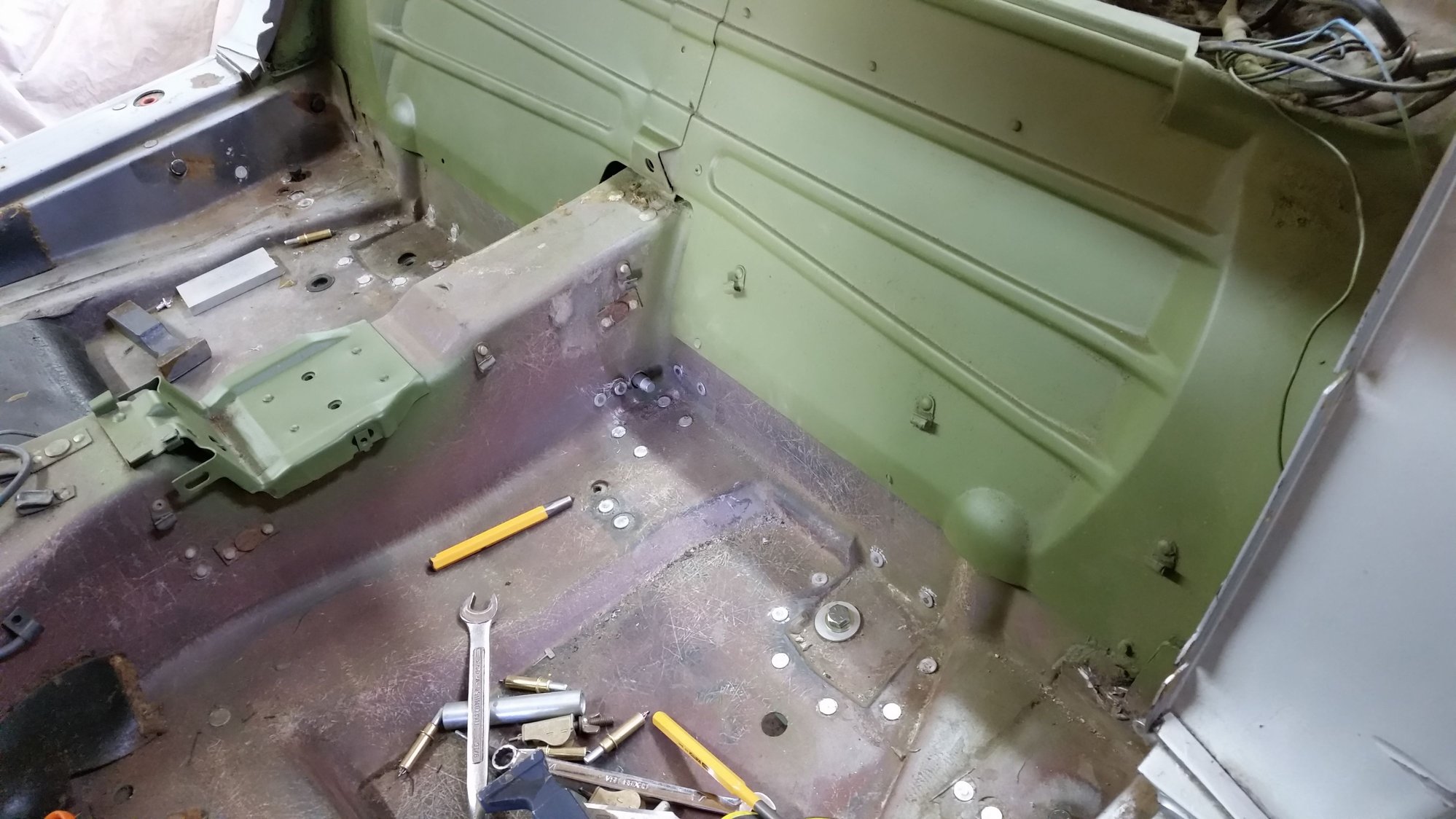

That is the way you attach the 69 seat belt.
The plastic piece covers the locking handle mechanism and protects it from water running down into the assembly.
Some shots of what things look like underneath.
