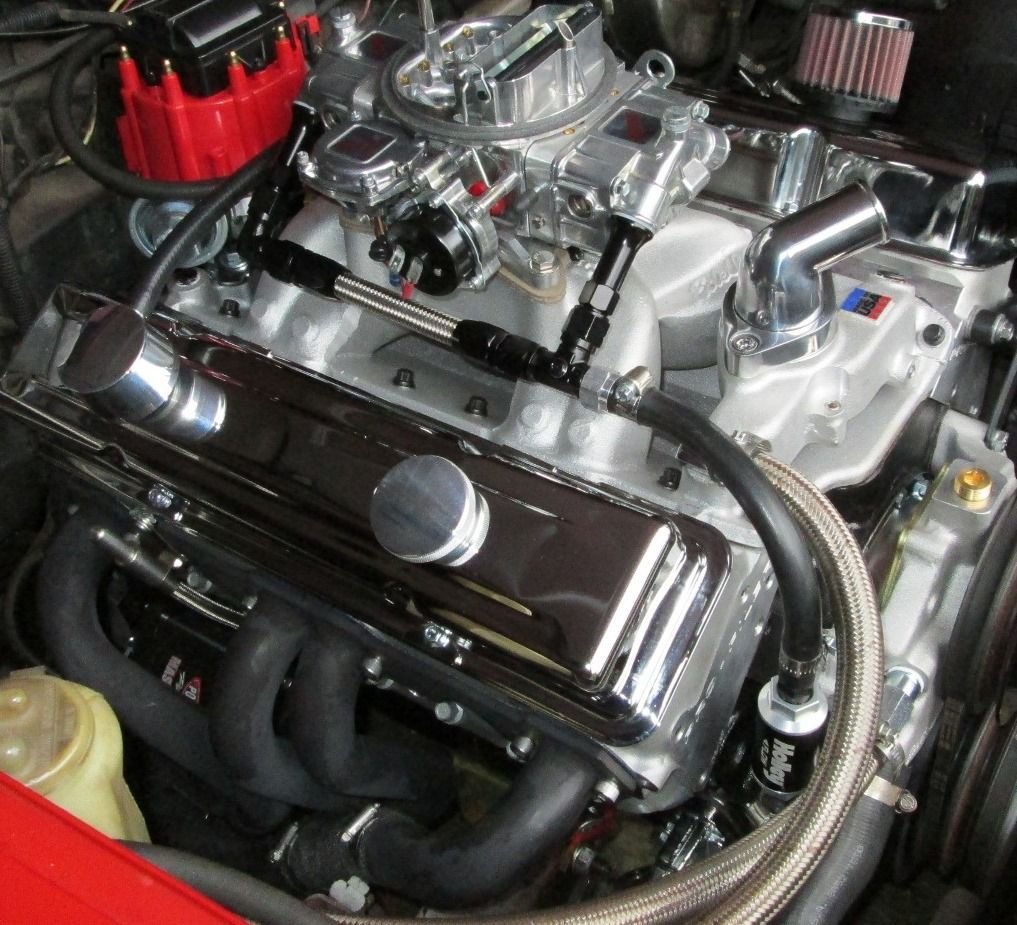

I have the same Holley pump you have. Here is the filter I'm using, just a suggestion. I'm at 486hp, but this should be able to feed much more. What kind of power (fuel consumption) are you making?

What I have is "optimal overkill" for a 385 stroker. But it would allow for a lot more hp if I ever want to go there. Every line and connector is no less than 3/8" inside diameter, and there are no hard 90* bends. I used earls 3/8" NPT nipples on the filter, and I found some curved 90* brass nipples for the pump. I'm also using very sturdy clamps built in the 70s, with fuel injection liners. I tried some fuel injection clamps from NAPA but they bent and stripped way too easy.

This is an old photo, sorry. First mock up of the plumbing. Made a few changes since 2013.

That's a nice clean setup, I like it a lot! I think that is the fuel filter I am going to go with. Thank you for the picture and your help.
