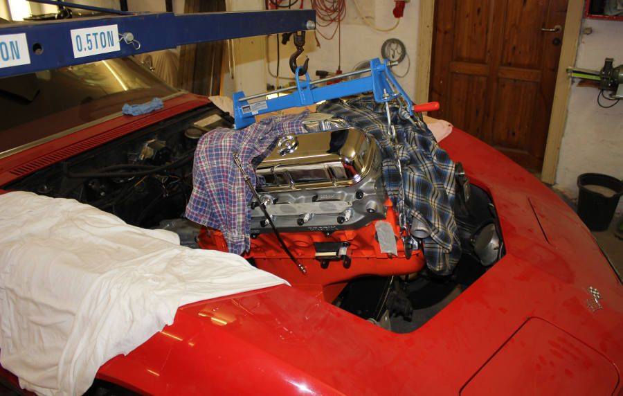

The rental cherry pickers jibs are too short to reach from the front. If it is just the engine, you can straddle the tire and install from the side. With the engine and transmission you need to remove the front tire and support the car on a floor jack. You must roll the car as you lower the engine and tranny. At least that is how I removed my 427 with a Richmond 5sp last summer. Attached photo shows all. Be careful with balance.

The front casters don't rotate/steer on the rental picker so you can't move the engine forward when approaching from the side. I did this all by myself and figured it out as I went along. It took a few extra hours trying to be safe. Note the floor jack must be behind the picker leg and parallel to the frame rail. Get help if you can. Extra eyes and hands will get it done faster and safer.
